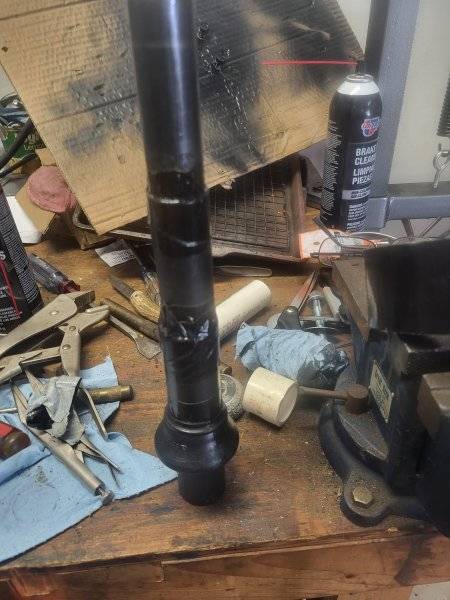

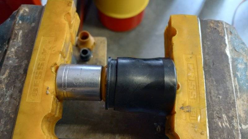

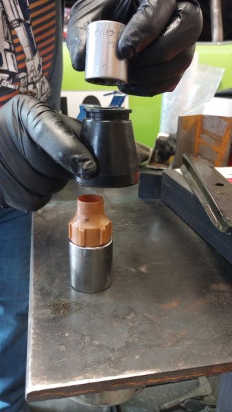

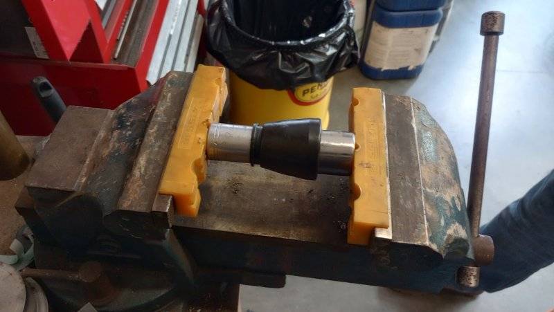

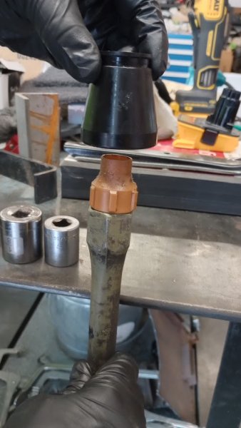

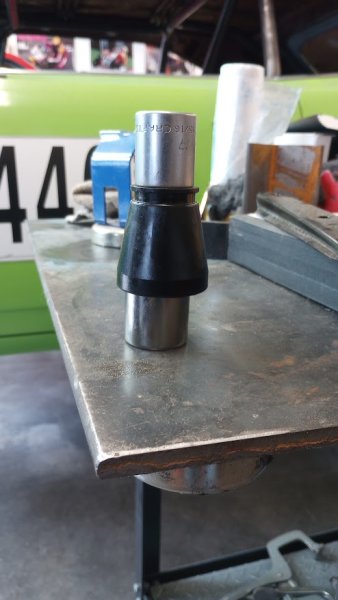

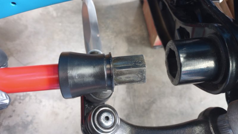

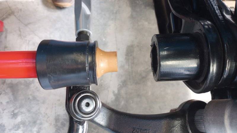

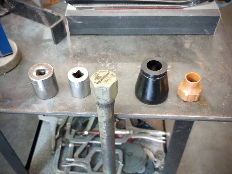

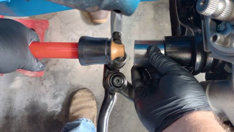

While putting larger torsion bars on my 1970 B body it looked like the boots looked too small. Even after adding grease, I couldn't push them on by hand. So I found a plastic plumbing connector that is the exact diameter of the torsion bar (point to point). It is the beige piece in the photos. With the correct socket sizes and my vice, I was able to press the plumbing piece into the boot. Then I held the socket against the boot after slipping the large diameter over the torsion bar and just grabbed the torsion bar and pressed it forward against a socket. The socket just pushed the boot right onto the torsion bar! No wrestling or fighting.
I hope this helps someone.

I did something similar with a stack of sockets that I taped together. Last one was the size of the torsion bar end. The poly boots slid on fairly easily.

OR you let the boot sit in a container of HOT water long enough to soften it up.
Get a small plastic kitchen funnel and trim the large end to just slightly bigger than the t-bar.

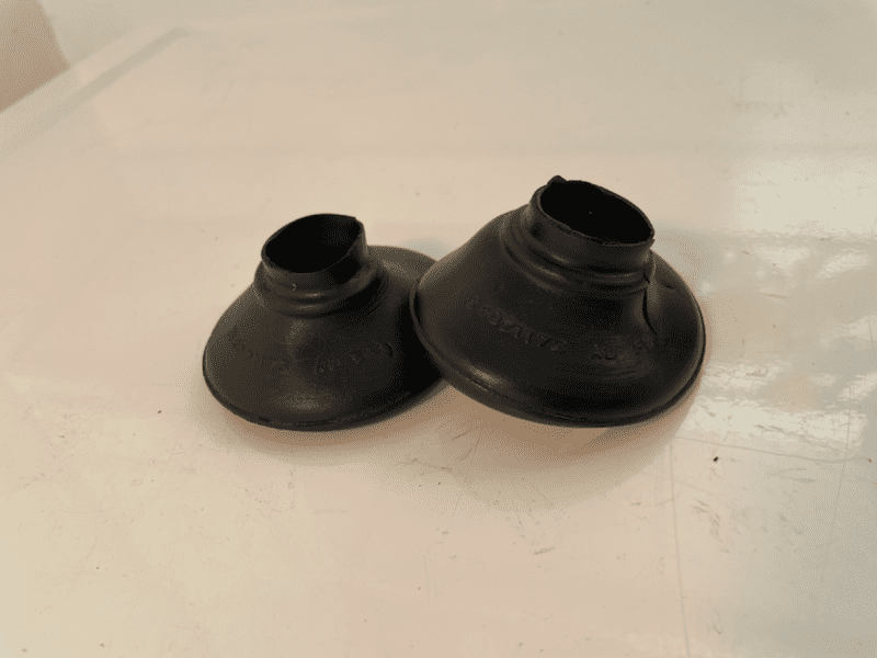

I’m new to torsion bars so forgive me for not recognizing this boot. I attached a photo of the rubber seals from my torsion bars. Is this the same part you’re wrestling with, but just a poly version? I thought the only reason for the seals was to keep dust out of the greased up torsion bar socket. What’s the benefit of poly ones?

The benefit is the fun factor of installation
Boy, I didn't know that there was ever a boot up at the control arm, just in the back. Never saw those on the 3 cars that I have.
It's for the rear. It just slides down to the back.
