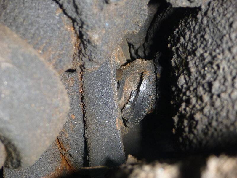

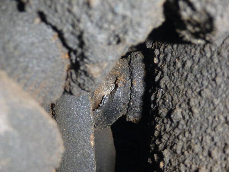

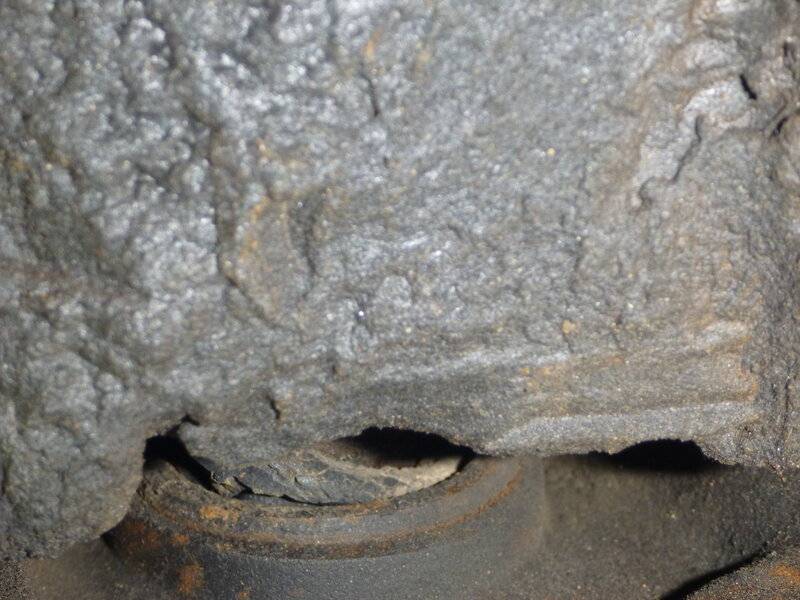

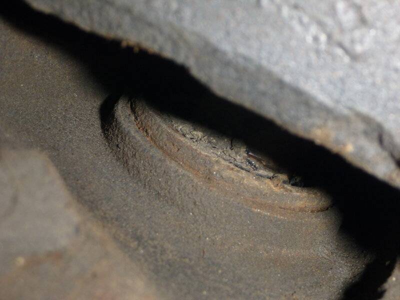

What is the condition of your lower control arm bushings? These are the bushings that the pivot shafts are pressed into. 9 times of 10 these are the issue and are indicative of the symptoms that you are describing.
James From
PST
Doing things willy-nilly always causes problems. Did you follow the FSM procedures ? Did you check the LCA bushings ? Did you set ride-height ?
As James (PST) points out above, have a good look in there. I bet, like James, that your LCA pivot bushings are rotted and fawked...

I would just want to add that changing the lower control arm bushings (which I have just finished) requires pulling a good bit of your front suspension apart. If you change some of the other parts, you may have to pull them apart again later to do the LCA bushings. I did mine separately after updating the rest of the front suspension previously and made a bunch of extra work for myself. Since the bushings are cheap and not that hard to change if you know the tricks, I would suggest changing them as part of an overall suspension servicing. Cheers!
