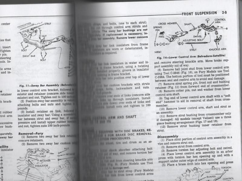

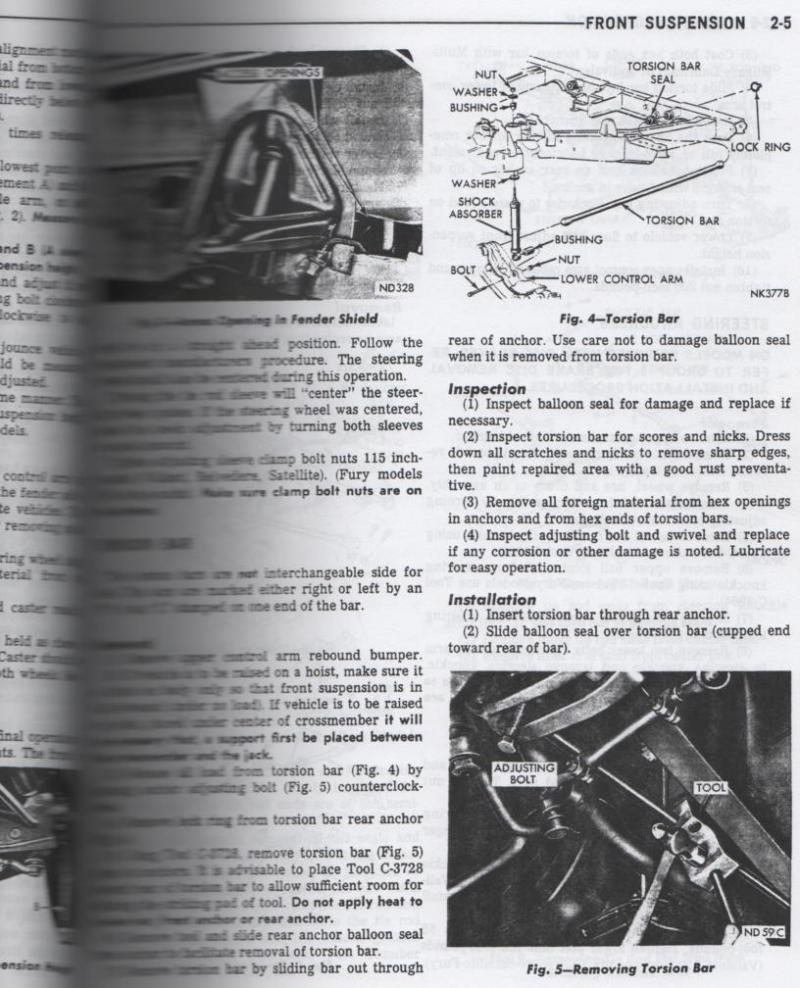

Here's a diagram
its not 3/4, its 13or15/16 on the end of the torq. bar.
Sounds like you're tightening/loosening the Pivot Shaft nut and not what you need to Shag.
On the bottom side of your lower control arms are your torsion bar adjusting bolts. And when I say bottom side, I mean they face the cement under your car. Another thing, you should be adjusting a bolt......Not a nut.
Crawl under your car, look up at the underside of your lower control arms. About mid point of that Lower control arm you should see a bolt head. Use those to raise/lower/level your car.
BTW, if you were accidently messing with the pivot shaft straight forward from the torsion bar, you should re-torque that to 130 Ft/Lbs per the service manual.
Good luck.

well guys i facked up. yea go ahead laugh, damit. trust me i am laughing harder than you are and kicking my *** at the same time. not an easy trick. i can't find my manual since the hemi install and i was erie of doing this but it had to be done, scraped the dumps a couple of times. as stated in 1st post i was on the 15/16 nut and couldn't hardly budge it with 1/2 rachete so go big or go home, 3/4 rachete with 3 ft extension on the hoist. yea dog, popeye stripped them:angry9:.
thanks ragtop for showing me the light. now to straighten out the mess and order a NEW manual. oops reverse that. get the manual 1st., dumb ***.
