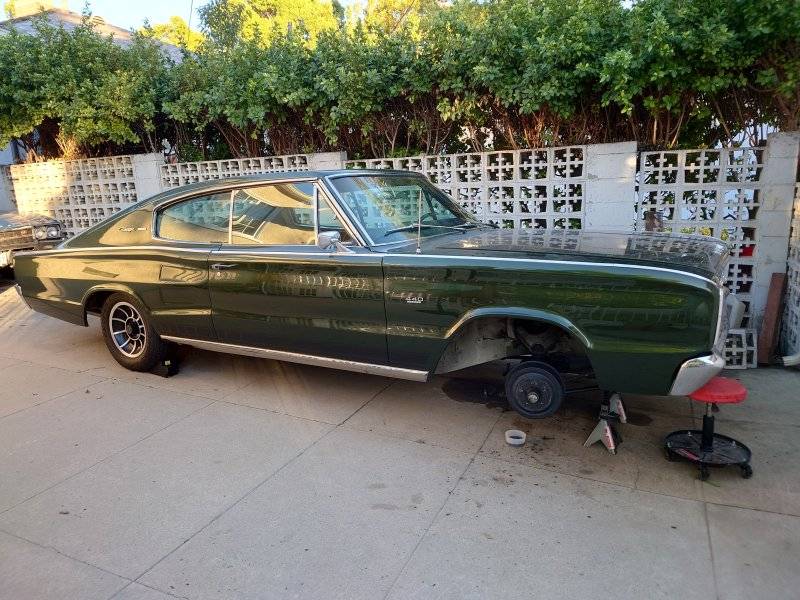

I'm rebuilding the front suspension on my '66 Charger. The car seems to slam into the road on dips and such. I expected the KYB gas adjust shocks to be bad, but they are ok.
So does that leaves me with worn out torsion bars?
I think they are original, I haven't removed them yet. The car was a 361, AC, power steering. The build sheet lists left as 777 and right as 776.
Now the car has a 440 with aluminum intake and water pump, the rest is cast iron. Currently no AC compressor but I plan to add a modern one.
Do I need new torsion bars? Where to buy? Spring rate recommendations?
Thanks.

Car looks awesome with that paint and vector wheels.

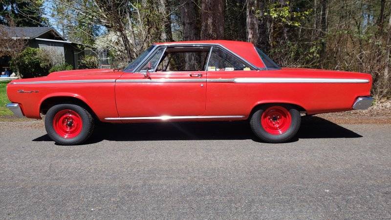

What front shocks would you recommend for my 65?. All new front end with disc brakes and rebuilt power steering box. 1.03 bars. It rides good, but I think it's not stiff enough. it tends to nose dive. The shocks that are on it are junk stock replacements. BB car.
In my opinion, rapid dive can be slowed a bit by a better shock but more of the fault lies with the torsion bar itself.
Here is what I learned....
In 2014 I had 1.0 torsion bars and KYB shocks in my red car. I changed to 1.15" torsion bars and Bilstein shocks at the same time. The ride was actually better with the second combination.
I don't have a part number for the Bilstein shocks. I called Firm Feel and ordered them from those guys. They are known as Bilstein RCD. (Race Car Dynamics)
Heads up: as you would expect the stiffer torsion bars are a larger diameter and could rub against exhaust down pipes or other junk.
