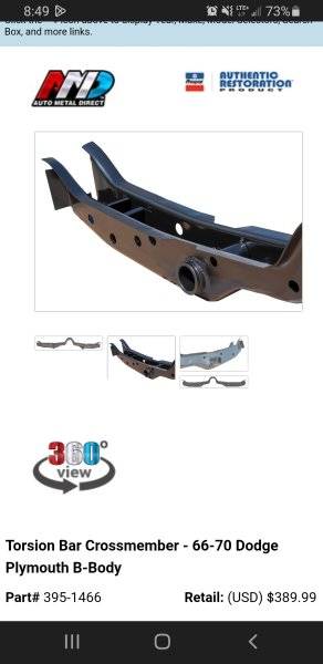

If that is just a cap that goes on on top of the rusty piece I would pass. Cut out old, weld in new is the best option. AMD makes full pieces.
Edit: Well crap...out of stock. Did yours rust out where the frame rail meets the crossmember? Maybe someone has a donor section for sale.

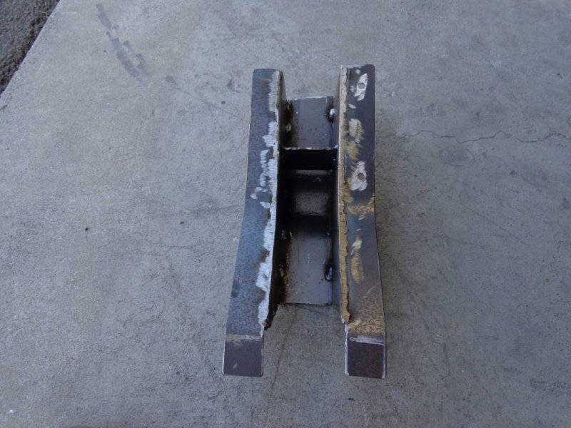

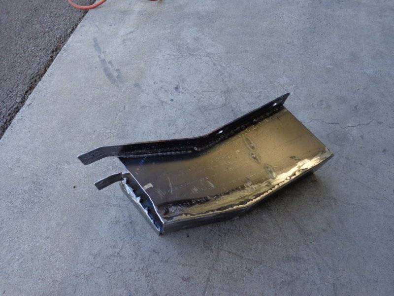

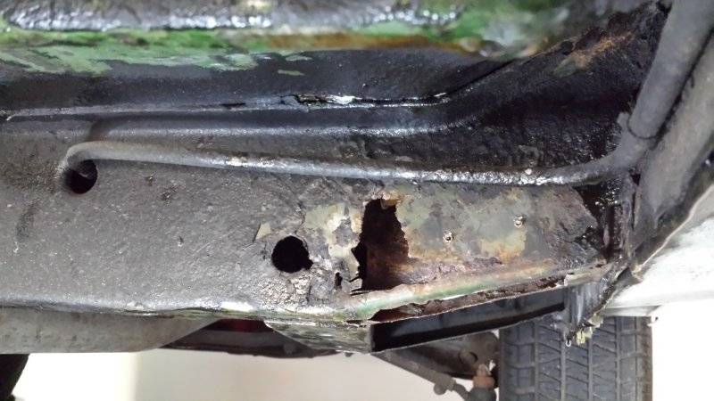

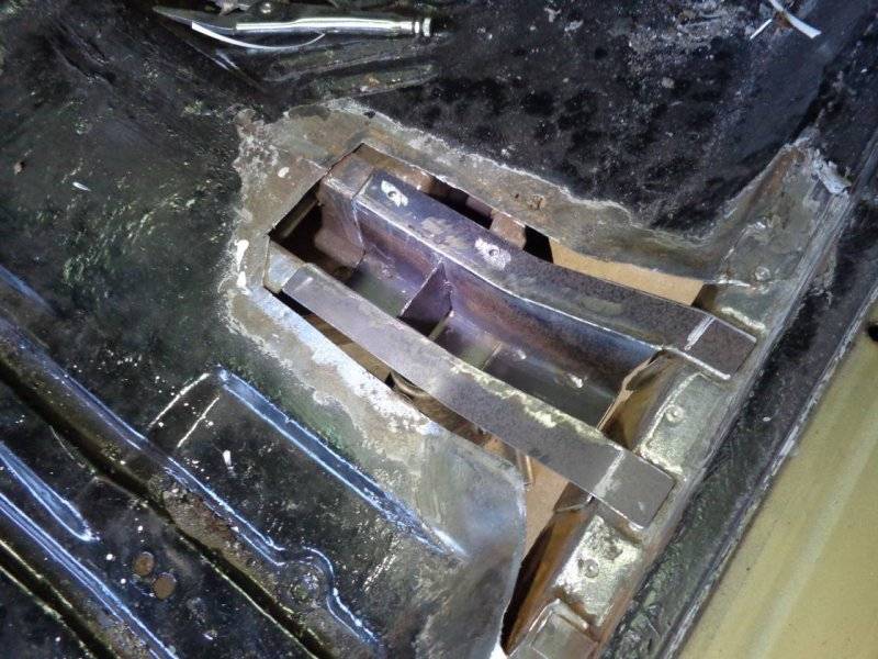

To give you some idea of the work involved here's some photos of mine from when it was fixed. Only one small portion was rusted, and before I started poking around it was one tiny area, but like yours it was bad.
I had to repair mine the same way only I had a donor section to use. It is very doable by fabricating a piece too.
I've done both....... donor section on my GTX and and repair on a Challenger with 16 gauge pieces....... anything but a cap

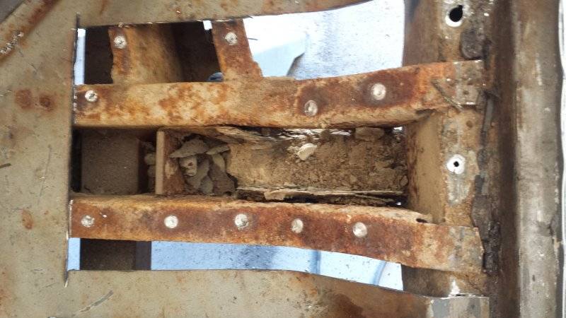

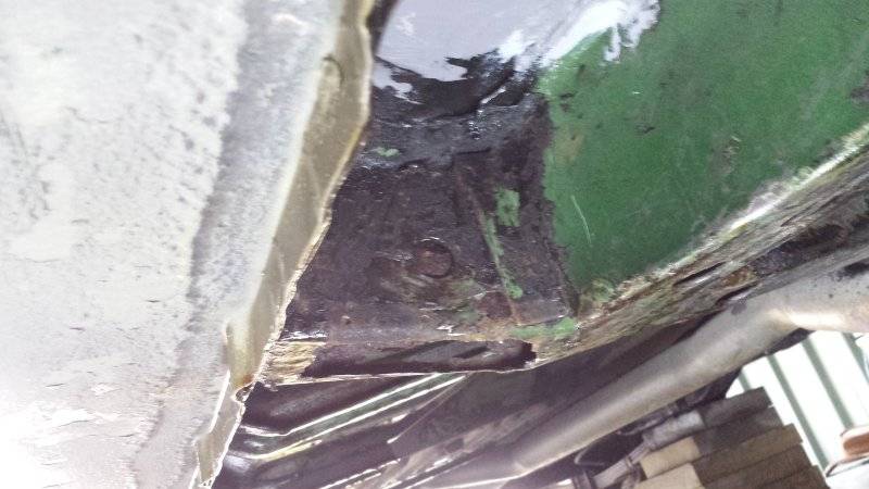

Finally got pics of the cancer. But think I already know what needs to be done.
