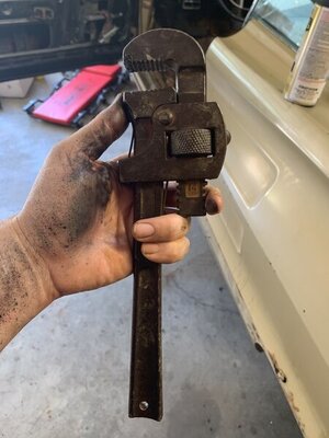

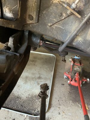

Ok, so I know you folks probably do this all the time....but I just figured a hum-dinger way of easing bars in and out......without a lot of the pain and suffering....
1. get a good sized pipe wrench
2. Affix it to the hex end of the control arm
3. Torque it toward you while tapping in the bar with the correct tool.
It gives you the ability to use a lever while tapping in the bar....so alignment can be adjusted the whole time....
******* amazing...
You should not use a pipe wrench on the torsion bars.
Never mind I see you say control arm.
Grandad’s ancient wrench.
816B4ACC-3292-4E16-91A6-5AD538505200.jpeg D3EA3AAF-632D-4F1C-B563-F0F980CDBD19.jpeg
A pipe wrench will mar the bar and cause stress risers then the bar will end up breaking. Which can cause injury or even death. Kim
Pretty sure you did not read my post sir
Assuming you only mean “in” not “out” so we’ll skip that.
Slack the screws pretty loose. Make sure you have the left bar on the left and right on right. Slide it in from the rear. Make sure you remember the dust boot. Grease both ends. When the front end makes it to the control arm line it up. Tap it from the rear with a hammer. Once it’s flush use a socket and drive it all the way in. Put the little clip in. Stretch the boot over the mount. Wind up the adjustment bolts close to where the dust marks are from the last time. Put the front end on the ground (good and level like a garage floor). Tighten them alternately to get the right height. Note that the factory heights had the nose up a fair amount. Remember the nose of the Challenger in Vanishing point? Like that.
