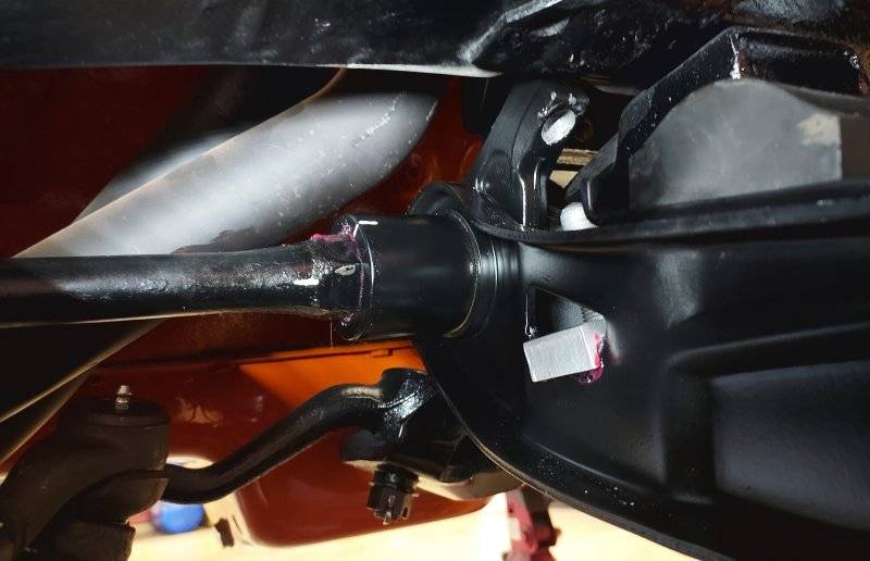

I tried to "clock" a t-bar wrong. Couldn't do it. The white marks in this pic will line up being in the correct location. It's one flat too high in this picture. Two flats lower the ear would be clear down into the control arm.
That’s my take too. Mis- clocking the torsion bars is almost an urban myth. Theres 30 degrees difference between the flats. It’s impossible to mis-clocking them (front way too high) because the a-arm can’t rotate that far down. If you raise the a-arm way up and insert the bar 30 degrees off (front too low) you will never get the suspension off of the upper bumper before running out of bolt adjustment.
