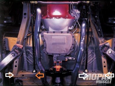

I think I am meaning the pieces where the torsion bars seat. I've included a picture to show what I mean. This is from an A body, but you get the gyst of it. haha. The ends of that crossmember are rusted out on the ends, but seems pretty solid other than the ends. I was wondering if you could patch in these end pieces. Or do I have to undo the torsion bars, pull out the entire crossmember, and replace it. where the bars are seated, currently, is still intact. 95% of the rust is past those points.

I just read my first post, and see why there was confusion. I meant torsion bar crossmember. hah. sorry guys, but thank you for your responses. :)
If the torsion bar crossmember is rusted out the typical fix is to obtain a good donor piece from another like car, your 4 door parts car will work. Drill out all the spot welds that hold the floorpans and the connection to the front subframe. You will need to remove the torsion bars for this. Place your new X member in your car and weld back in the same location. If your crosmember is not rusted out too badly you can use a product from Auto Rust Technicians called a Saf-t-cap that fits over the crossmember and re enforces the mount. Check it out....
http://www.autorust.com/safetcap.html
http://www.autorust.com/trm.pdf
Hey Ken. I know my crossmember bar is solid except for the last 6-8" on each end, past the points where the torsion bars join the crossmember. Could I just blast off all the rust, then cap it with one of those T caps from the website you mentioned?
Technically yes, you could do that. The problem is usually there's much more rot on the rocker side than you can see. This will become apparent when the blasting is done.
