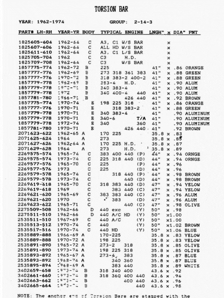

Here is the stock torsion size chart.

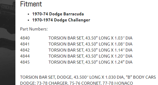

PST 1.03" bars are nice.
i looked on PST and i only seen the shorter bars for 72' and older.. 73 bars are longer
That's strange - they have them for '72 Chargers, but no listing for '73 Chargers. The '72 is listed at 41" length. They also sell 44" long bars for C Bodies. Maybe it's just the website - how long are the '73 bars?
43.6" per the chart above.

I believe they are 43.6"
