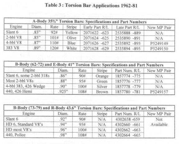

im looking for a set of big block torsion bars does any one know who sells them n what length they should be for a referance i have two bent sets n the one that are closest to what i need seem to be over 43 inches but im in need of a good big block set if any one know who sells them n what lenth they should be please let me know. thanks pat u can also email me or call me at m16king@netscape.net or ph at 7016261844 thank again all oops my bad i for got to tell u what its for lol its for a 74 roadrunner with a 440 thanks again
42" bars 65 to 79 B body. Mopar performance has them. You can get them from mancinie raceing.com
i looked at macini racing n are only for 66-71 b body models arnt the 74 roadrunners 43 inches and others are 41 somone please help me im realy confused now or will the ones from macini racing work? i dont want to buy somthing ill just have to send back any way n with my resoration they wont be put in right away any way thanks again pat please email me or text or ph me at m16king@netscape.net or ph at 701 626 1844

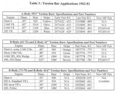

Here are the numbers but I dont know who sells good 43.6" sets for 1973+
