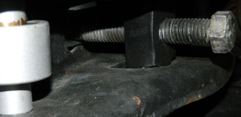

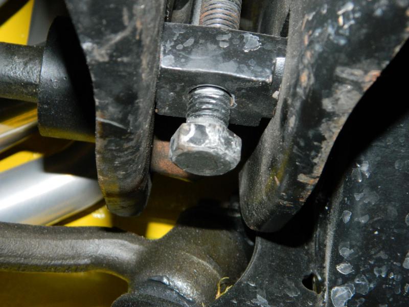

Hi guys, so while installing a new transmission in my 74 Satellite, i pulled out the torsion bars and bracket for clearance. I noticed that the bolt on the passenger side lower control arm was cranked much father in than the divers side. I just had it aligned recently. Is the passenger side bar worn out? or bent this side of the car had been in a accident that bent the lower control arm.
Passengers side

Drivers side

I have a donor car with torsion bars, should i swap the passenger side in? or is this some what normal?
It could be that the one side wasn't clocked right when the torsion bar was installed. Your supposed to make sure that the socket the torsion bar goes into is rotated all the way down before installing the torsion bar.
It is normal for them to be different depths into the nut on any given car. I would be checking things if they were even on both sides.
