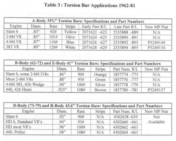

can someone tell me what the 3 digit number on the end of torsion bars mean
if you have a number.... you can identify the TB for example 777 is a Driverside 0.88 inch TB for a B Body
