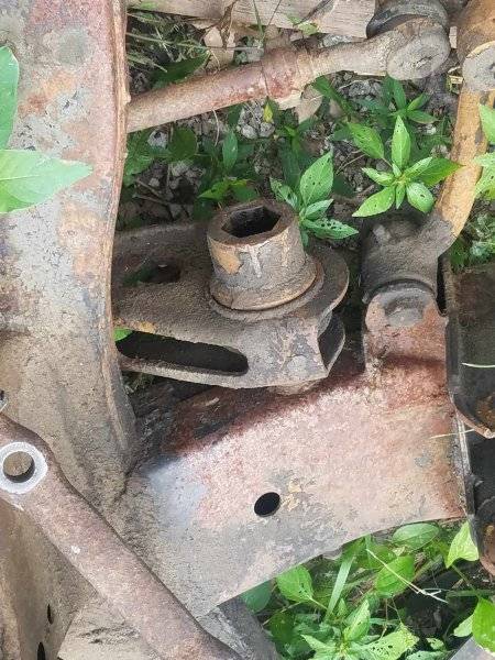

Playing with the idea of taking the torsion bars out, leaving them out and stepping over to Koni Coil overs on the front. What I am seriously concerned about is will the lower control arms stay in place, or dislocate themselves from their pivots?
To cut to the core of your question... the short answer is "yes", it will come out, eventually, without the TB in place.
The LCA bushing for the pin does not have the ability to address lateral pressure for extended periods. Although some may disagree and note the small retention clip at the rear of the TB as evidence to the resistance of the pin to move rearward, they may be missing the fact the static load alone on the TB is more than adequate to retain the LCA pin.
On a broader note, the coilover alone will not likely get you what you're looking for. Yes, you'll get more space with the TBs gone... for headers and will certainly make working on it a little easier, but it's very unlikely you'll see changes in handling beyond what a quality shock, upgraded bushings, a plated LCA, and a decent, correctly sized TB will get you. This is why serious upgrades include replacing the k-member and introducing new shock towers (i.e., Q1).
If the goal includes primarily getting space under the car, which I can respect, I recommend removing the TB's, cleaning them thoroughly, greasing appropriately, and just doing good maintenance on them so that when work is needed in that area, just yank them out. Takes me less than 5 minutes to remove both TBs in my car. It's just not a consideration for me anymore because it's so easy. And yes, I drive my car a lot.
P.S. When I say I remove my TBs.. I mean disconnect from the LCA and slide to the rear. I do not extract them from the cross member. That boot is just too much of a bear to deal with.

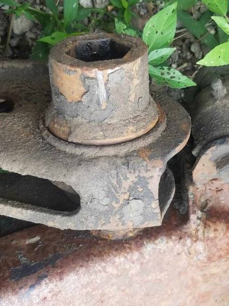

Well before I up and do something , before I make a irreversible mistake I ask. In the pictures I posted I'm guessing that you all see the torsion bar location on the lower control arm assembly. Understand " yet " I don't know if the bolt/attaching point of the lower control arm starts at the cup area if you will, travels through the rubber/neoprene insulator, then mounts to the k-member. And I doubt it does myself, be great if it did, but doubtful. Now what I was thinking was manufacturing a bracket off the K-member to hold the torsion bar cup in place. I can see it as being possible. I can't see it as ever being serviceable. Get what I mean?
