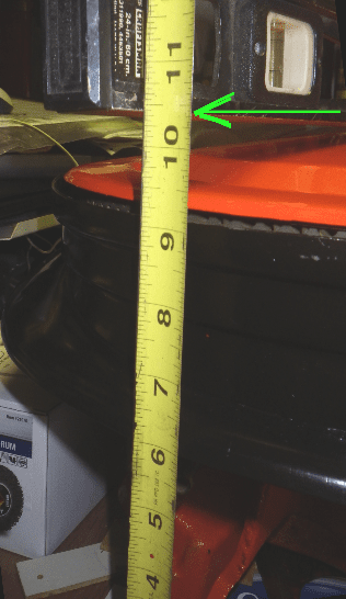

Looking for this measurement:
From the pad, 10 inches to the top of the lid, on a RB.
to the OP: on a RB, the pad is the flat pad in front of the block, right behind the water pump housing to the right of the distributor hold-down clamp
Thank you for the help.
Which part of the lid did you go to?
I'm coming up with 10-3/8".
The peak of this repop lid is approximately 1-1/16" above the element flat.
