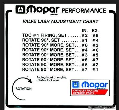

I am sure the adjustment is done hot, but what are the specs?
This is a chart to follow when adjusting valves.
Every hemi has oil in plug tubes unless you fitted the heads with aluminum o ringed inserts. You don't need to remove valve covers to pull tubes. Hemi's pool oil around exhaust sided all the time. Let a little oil get past the guides is ok on street motor. Get the Viton valve seals instead of Teflon. They are green. Check your adjusters make sure they have tight thread contact with rocker arm threads. If not get a good set from isky. Hemis are not for everyone!
