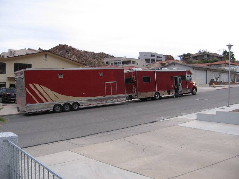

I found what you need :)
Neighbor was a racer. About 5 years ago got hit by a car on his bicycle. BAD.
They sold this rig on Monday.
