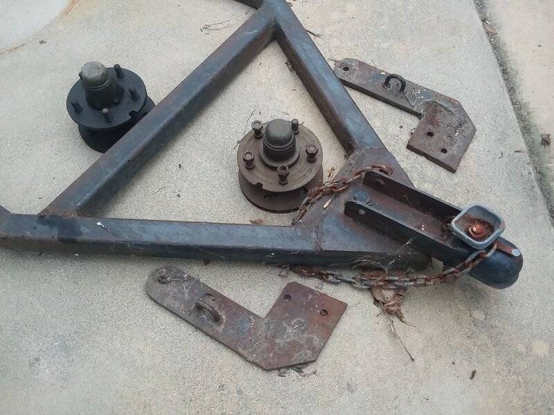

However, this is what we flat towed our race car to the track with, in the eighties. The tow tabs bolted to the bumper bracket mounts, the tow hubs were made from 1/2" steel and amc hubs, and the tow bar is 1/4"wall (it's heavy!)
We towed it out with the slicks in the bed (or the trunk) took off the stock rims and street tires, took off the tow hubs, and put the slicks on. Unbolt the tow bar, and let's go!
I did it the same way in the 90's before I got a trailer, except for the hubs. I just put the 4 speed in neutral.
It's funny how much my home made towbar resembles yours.
My 1st drag car came with a home made tow bar like post#6. Simple angle iron bolted to the stock bumper mounts. After a couple years towing 15 miles to the local track 2-3 days a week, got towing hubs & towed from St Paul to Byron, Il 350 miles 3-4 times a season in addition to the local track. Then built the trailer.
