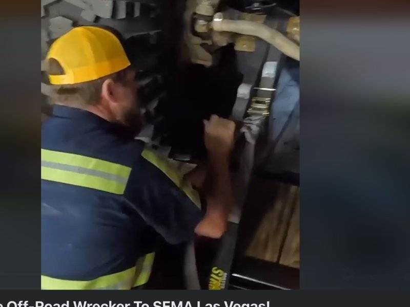

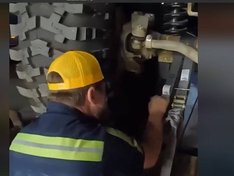

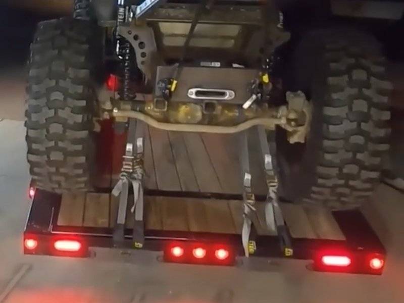

Here is Matt’s off road recovery and now he ties a vehicle to a trailer.
He does off road recovery in Utah and Arizona area. Plenty of videos online. Pretty interesting things he does.
