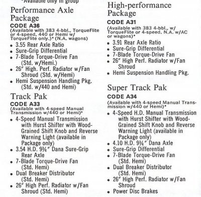

It's a common confusion but the only way to get a four speed behind a Hemi/440 was in the Track Pak/Super Track Pak package. A four speed is not a stand alone option for the Hemi/440 like it is for smaller engines. It comes with the total package. Here are the packages for 69. 70/71 is similar.

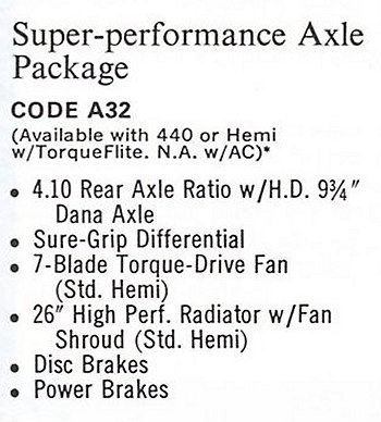

*** Also available 440-6 auto***
The A32 Super performance package (4:10 Dana et al) was available behind an automatic. Track Pak and Super Track Pak cars are four speeds.

Great chart! Looks like I got A33 on the Coronet. New Challenger tracpac is 6 speed pistol grip, Gertrag, gears, and anti slosh for ps fluid. Non MDS.
