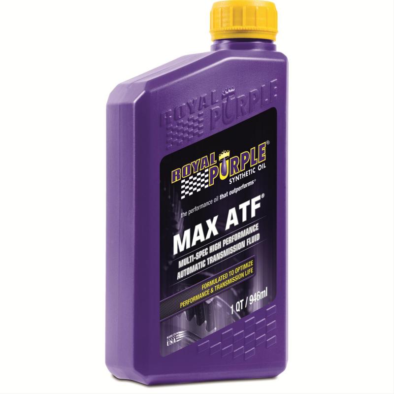

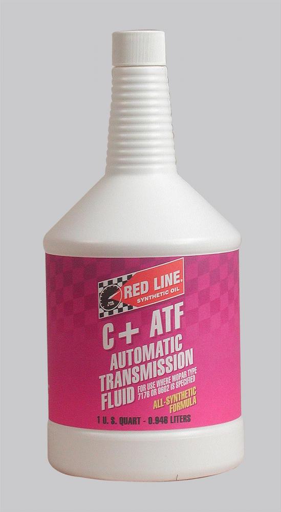

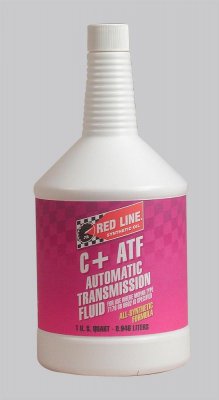

So is Redline C+ ATF All-Synthetic Formula 30% greater hi-temp viscosity, formulated for Chrysler ATF+, ATF+2, ATF+3, ATF+4 for Type 7176 or Type 9602 transmission fluids, has less hi-temp evaporation compared to petroleum based oils, it keeps clutch faces, bands & shift valves clean, perfect for heavily loaded performance transmissions... Also Royal Purple Max ATF, is a Chrysler racing Oil ATF+4 rated, used in my 99 Dakota SLT 4x4 for quite a few years now... Neither of them are cheap, but work great, I've used both for quite a while now, no failures or overheating ever... I use to use Torco Racing Trans Fluids ATF+3 & ATF+4 Chrysler spec. in my racecars & either the Jeffco or Lenco trans too, even used it in a Clutch-flite I had for a while, it was really pricey even 20 years ago, I got it free/sponsored from ERC/Torco Racing Oils, so I used all their products... never had any issues with that fluid either when allot of people around had failures & burned up transmissions right & left.... Sometime you actually get what your paying for in oils & fluids especially... my $0.02 cents
  • Redline C+ATF Chrysler (AFT+4) racing trans fluid red-30604 $11.99 qt..jpg

I havent used those thanks for the info
