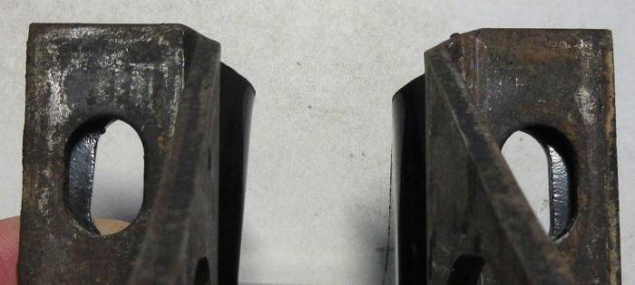

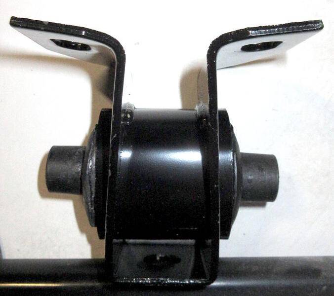

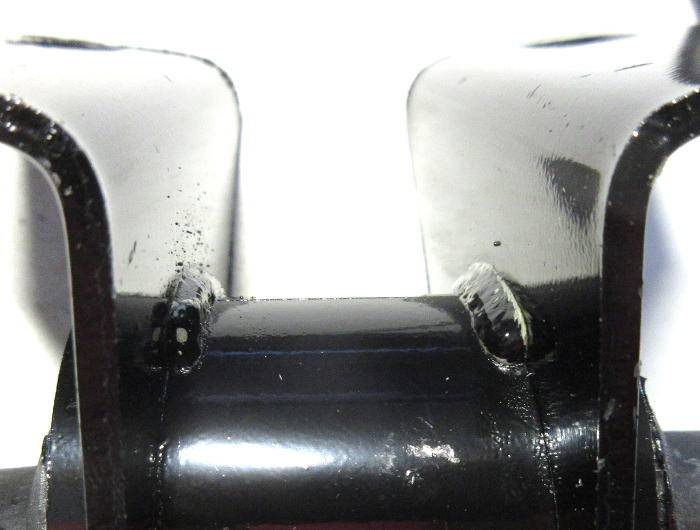

Here is a Marmon DEA A2512. The metal is only 2/3's as thick as the stock mount - I believe the way they are getting around using the thin metal is by welding it to the bottom of the bushing, which may not be a bad idea from an engineering perspective, but the sides of the mount weren't straight when the welds were done. As you can see in the last pic, the holes don't line up (and as you can see in the first pic, the mount doesn't sit flat either!). I'm not sure this is useable. Somehow I'd have to bend the legs out, which might break the welds, and affect the height of the mount, changing the angle of the transmission by a degree or so.
I've got the old bushing out of the stock mount. I have the feeling I'm going to end up ordering the Energy Suspension polyurethane bushing and reusing the old mount instead of this wonky Marmon mount. At least I have the pleasure of knowing Warren Buffet made a few pennies off of me.

Incidentally I fixed my replacement mount and put it on the car. I used a wood splitting wedge to bend the legs out enough for the holes to line up. I don't know how long it will last, but I've got the poly bushing in the old mount as back up, so no biggie if the Marmon fails.
