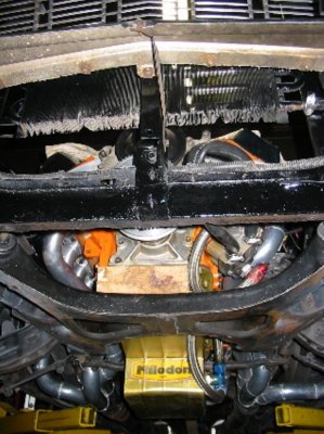

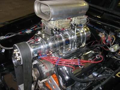

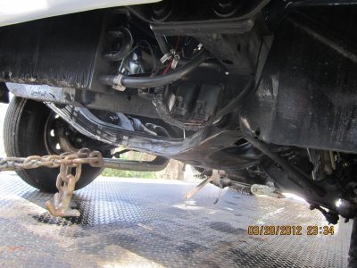

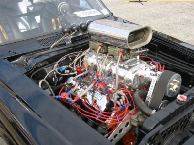

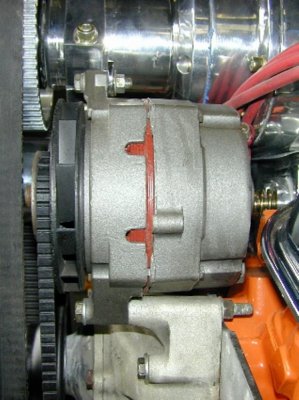

I use a "C" body radiator that's been recored with the high cooling capacity 3 row nascar style fins.Aluminum water pump & mopar water pump.The dual fan is out of a late 90's V8 Camaro/firebird that was a puller and I reversed the polarity to make them pushers with a separate relay & switch for each fan.The trans cooler is of the huge family w/o any add'l fan.The alternator I've been using for over 10 years is a 100 amp 1 wire large style GM unit.When I'm cruzin with the fans on,I never see the system pull more than 40/50 amps and on a 90* day sitting in bumper to bumper traffic the temp does not go over 200* and will fall back to 180 to 190* depending on the conditions.I don't disagree with any opinions as far as flowing trans fluid through the rad or not,I just never did:head_smack:

Thanks for the pics.
