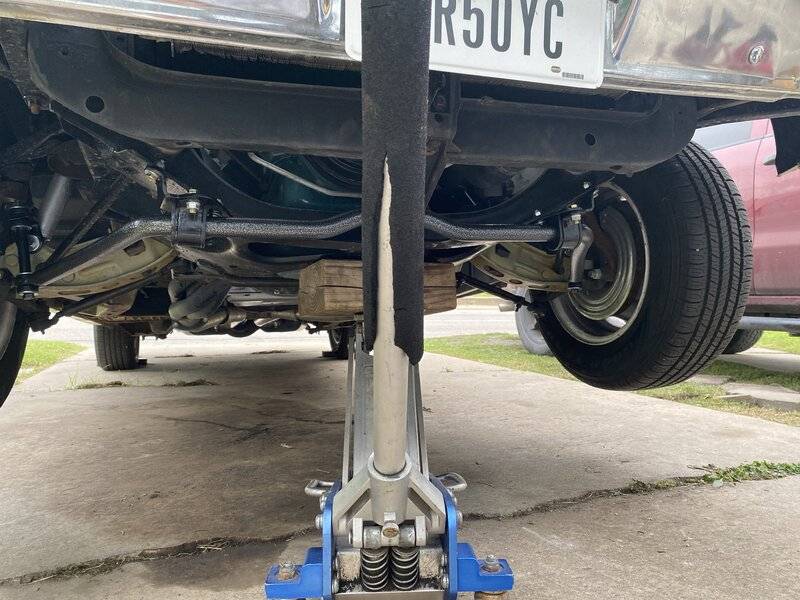

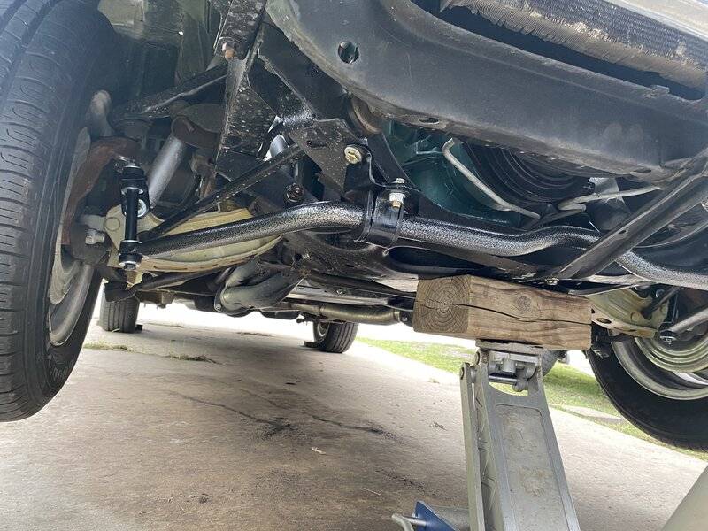

Is it possible to have the transmission leak if I jack up the car at the front. I installed a sway bar today and had the car jacked up from the front for two days. I replaced all the seals on the transmission two weeks ago and it was not leaking at all after I installed it. When I finished the sway bar I put it back down and took it for a spin. By the way, huge difference with the sway bar and adjusting the steering gear. Now that it’s back on my driveway I peeked under the car and saw a small drop under the bell housing. I kept my eye on it and it was only about four drops which seemed to have stopped now. Only logical explanation I come up with is that some fluid leaked out the torque converter and settled at the rear of the bell housing, then came forward when the car was lowered again.
? on the oil leak. Nice sway bar, did you get a stronger bar from the previous ? I don't understand the part about adjusting the steering gear. How did that effect things.

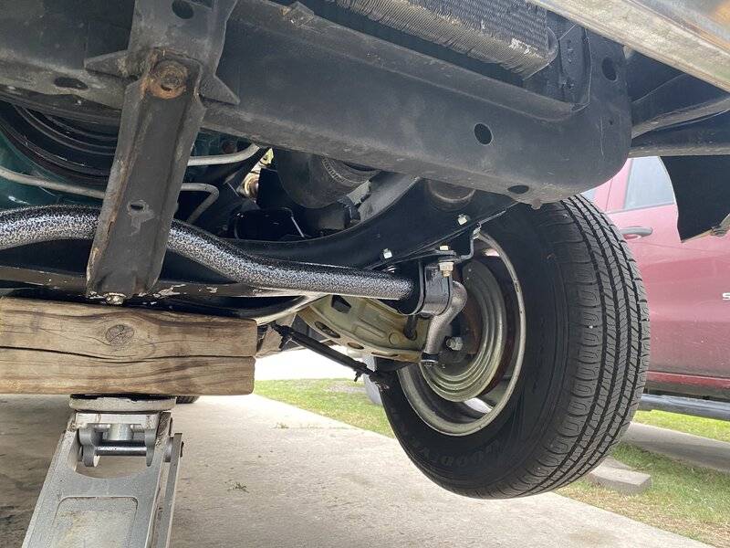

My car did not have a sway bar originally. The one you see is the Summit 1-1/8" which works great. The steering gear on the top has a lock-nut and a screw that can be loosened or tightened to bring the gear up or down. This allowed me to reduce the amount of play the steering wheel had side to side before the tires start responding.
