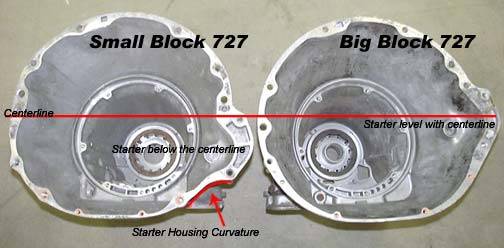

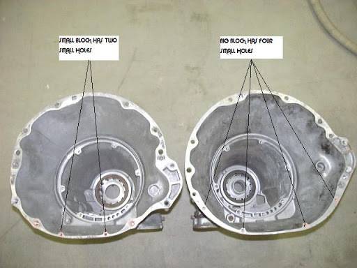

904 is small block 727 can be for either. The bell housing portion for a big block would be larger. And starter location is different as you can see here. Found these pictures on the web.
