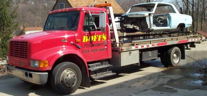

Shouldnt be too much trouble...
I've done this before with a 67 GTO.
1.Trailer (no railings)
2. 4X4 or 8X8 donnage
3. cargo straps, good ones like I have, US Mil style...
Load it on the flat bed trailer sitting on the Donnage (Wood)
Strap it down...
x2, done it this way a few times...

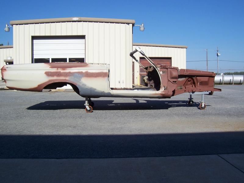

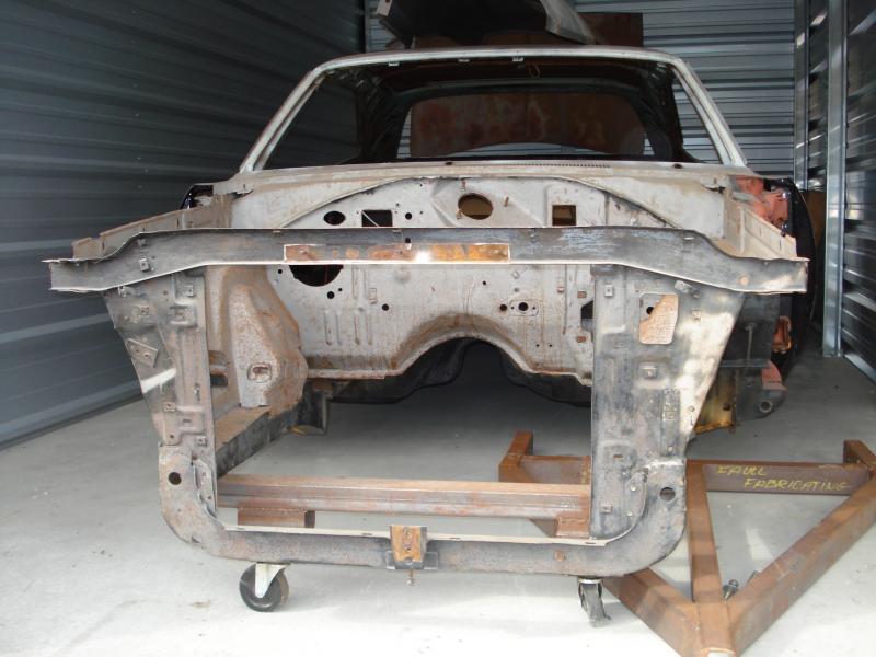

In the time it takes to make something for the back you could just bolt in a rear. For the front I just used a piece of channel, welded 2 casters to it and bolted it where the K frame bolts to. (I should have used heavier casters).
