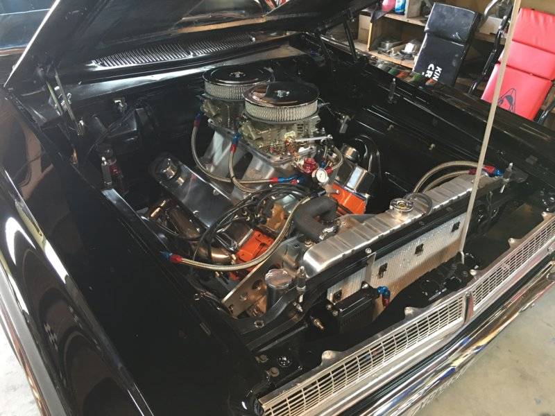

that how mine rout , around the frame rail with one tube on both sides
all i have right now,,these r hedman 2" race headers same as hooker,,,mostly.Pictures of the passenger side header on engine?? Please
all i have right now,,these r hedman 2" race headers same as hooker,,,mostly. View attachment 937237
fit was perfect, no dinging on any, installing 3 piece headers is like a header install vacation, u will never want to instal 1 piece units again after these, they r that easy with slip on collecters. supposed too, new motor has trickflow 270's angle plug..all cylinders have great clearance, 1 tube mite require shorty plug. they r going to fit! lol.Hows the fit / installing the headers and spark plug access? Will the Hedmans work with angle plug heads?
