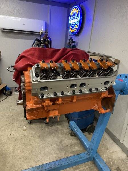

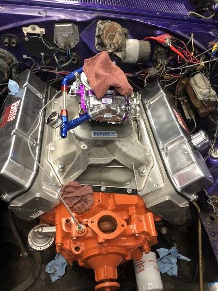

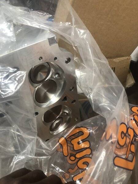

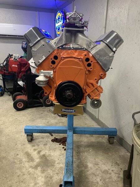

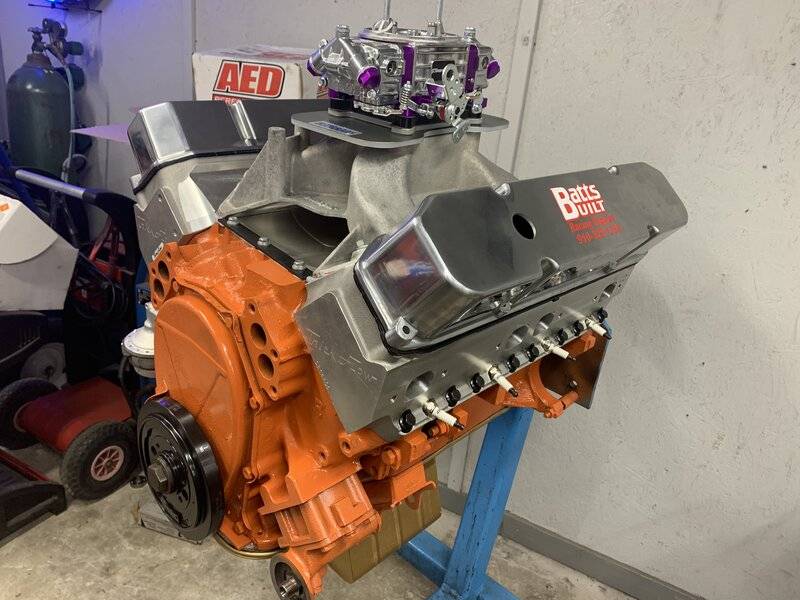

Don’t have the Tricflow intake but use Trick flow 240 heads, the recommended Harland Sharpe rockers and a M1 performance intake. As someone said there’s no way you’re fitting it under a stock hood. I run a 3” Six Pack hood and need to use a dropbase air cleaner.
Couldn’t tell you exact numbers yet but I’d wager the car is in the high 500s/low 600 HP. And mid 600 TRQ @ the crank. The car is also a 512” stroker so I couldn’t comment on a stock stroke 440.
Either way - the heads and rockers worked magically and I’d recommend the combo to anyone who didn’t wanna work with stock heads. You will need custom pushrods.
