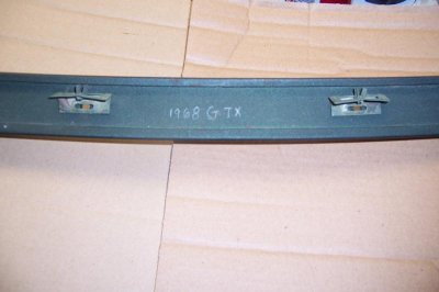

They need to be removed when instaling the new headliner and the ones removed cant be reused as they have some tabs that need to be bent.My guess would be they were never reinstalled and the trim was screwed into the windshield gasket.R/T Specialities has them and made to snap in place.$19.00 for the bunch.Just feel where the holes in your trim are and you should be able to locate the square holes.They actually help hold the headliner against the little picks.
Hello. I think this is the clips your looking for.

Thank you Dave,the picture explains why I had so much trouble getting the screws to grab onto something.messed around with it and got all but one of them to bite.

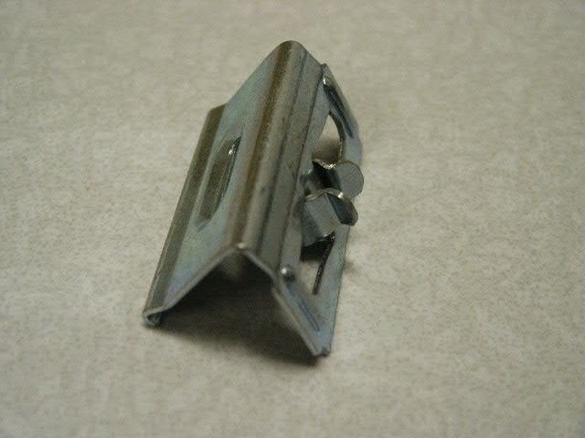

The new ones look sorta spring loaded and appear to snap in.I reused my old ones,drilled a 1/8" hole through the center,curled the tabs in towards the center and put them in and ran a sheet metal screw through the hole to expand the tabs.It worked and they are tight.Here is a pic of the new ones.
