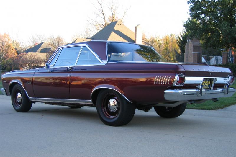

I ran into the same problem with my rocker moldings--after exhausting my search, I made my own out of stainless steel--carefully measured, drilled the stainless where appropriate, inserted spring clips through the holes and pressed the moldings in place. Works great with no looseness or rattles.
Good luck;
Bob
You could, of course, just update your fastener method and do what new car makers do; use two sided foam tape. No rattles and very secure. You may have to double up for thicker air gaps.
