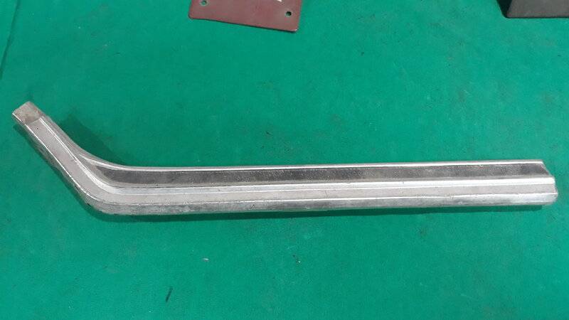

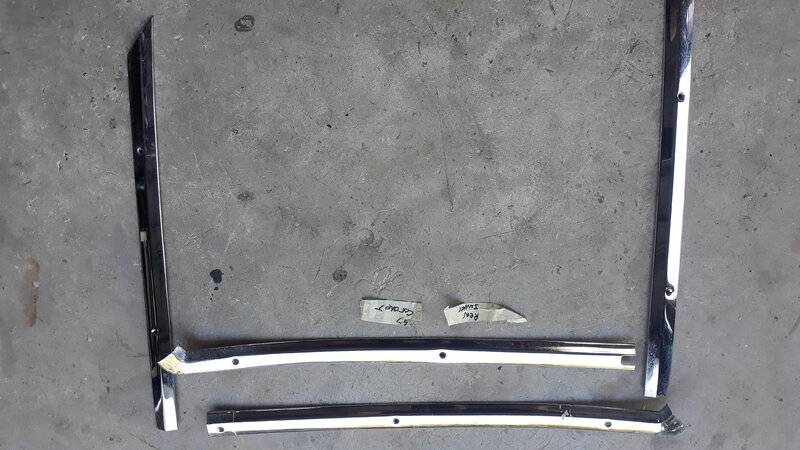

This trim was marked 67 Coronet. Inside rear window. Does it look correct? And would it also work on 67 Satellite/GTX. ?

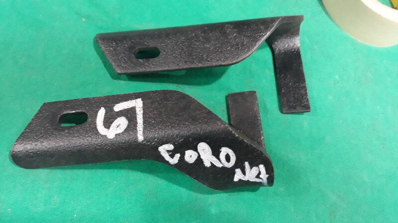

And this piece also.

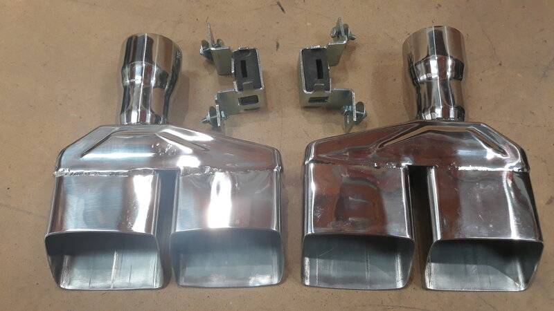

I may as well add these in !

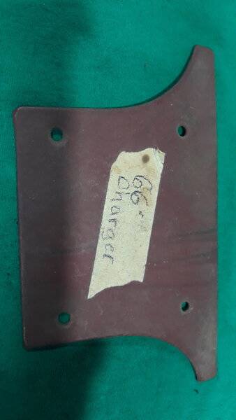

And the one marked 66 charger , look correct? What else would it fit? Thanks for the help !
The middle to brackets look like rear exhaust hangers for a 73-74 E body..
Thing on those exhaust brackets, most folks won't recognize them, most are familiar with the 70- to early 73 style brackets... Chrysler changed the design in mid-73 because the original design hung the exhaust off the trunk floor pan & the trunks were rusting allowing the exhaust to hang down... In 73 the new brackets hung the exhaust from the frame rails...
Like for the hangers in this pic?
Yup, those are the early design...
If I were home right now I would post pictures of the design you have, I have a pair too, from a car I parted out in the 90's... But they are uncommon enough that when I searched for a photo to post I had no luck...
Thanks Sam !
If the steering column cover is metal, it would most likely be for any 66 b body. They are narrower than 67 b bodies. Most 67 covers I have seen are plastic.
If a am wrong, I hope someone will correct me.
Yes , this piece is steel.
