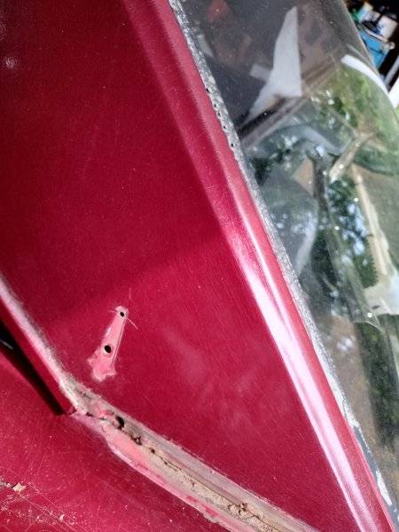

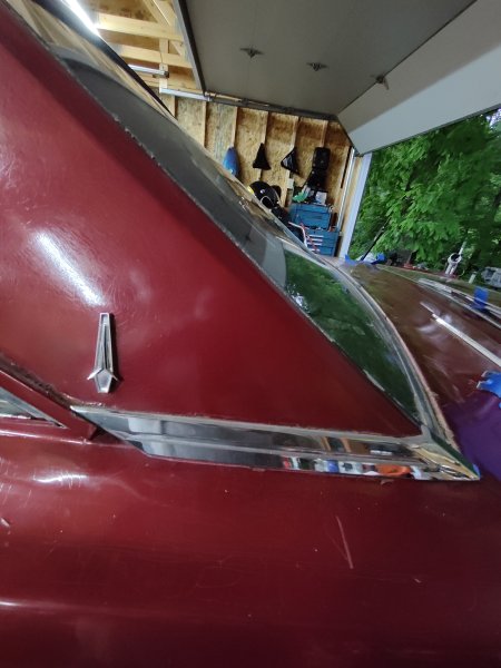

I need advice on removing these pieces without damaging anything.getting ready to rip the paint off.
Fun times coming your way! They both bolt on from inside the car.

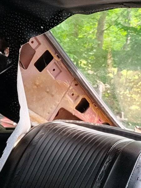

Remove the "teeth" that secure the headliner. This is not screwed on it is crimped in,place, so I don't know how to remove and attach again other than screw it on (Or plan B is to drill a hole in the teeth panel to access the rearward nut for the trim)

are they bolted in from behind?
Be very careful in case the pot metal studs are corroded. Possibly try tightening the nut slightly to break any corrosion if there. Then loosen it. Delicacy is the key word.

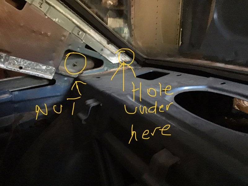

Photos. The chrome is pot metal, it's soft. The nut is plated and water does not sit anywhere near there, so it will come off just fine. DO NOT tighten the nut first. Use a 6 point socket with some putty in it so it will retain the nut, or else it will drop inside the quarter panel.
Here is a photo. Read the notes.
The small emblem will have the nut out it the open.

good advice, thanks

If I remember ,those headliner strips are held in place by clips that rotate 90 degrees. Once each clip is turned it will release that strip.
I was just wondering where the rear nut was and how to access it. Unfortunately, the front stud is already missing, so I'll have to get creative when reattaching.
