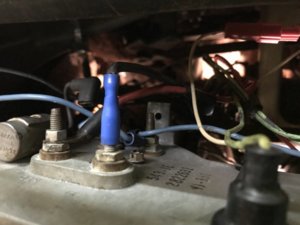

hello all. I have a 67 charger. My gas gauge don't work. I put a new sending unit and new gas tank. I put a new ground strap on as well. I have resurched somewhat why it's not working. I put on a new limiter. Where does the blue wire coming from the sending unit go? To the limiter? The gas gauge? I get the pulse with the test light from the limiter. But no pulse from the gauge itself. I'm lost on what to do next. I'm not ever sure if it's wirered correctly. I only have 2 prongs out the back of the gauge. The ones I see online has 3. Any help would be greatly appreciated with this charger.

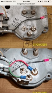

Yes I read that. On that photo the gas gauge has 3 prongs coming from the gauge. Mine only has 2. This is a photo from that page showing 3 prongs.
I would think one of the 2 wires has to supply 5v coming off the limiter...And one is grounded off the limiter to the hex screw on yours.....Does your limiter have 5v?
