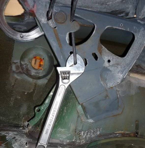

You can add more tension to the torsion bars by moving to the next hole... It can be dangerous, first find a prop rod so if the torsion bar gets loose the trunk lid doesn't fall on you....
I've seen pictures of a couple different designs of tools to adjust the bars but I've always done sketchy stupid stuff... So here's a picture of sketchy stupid...

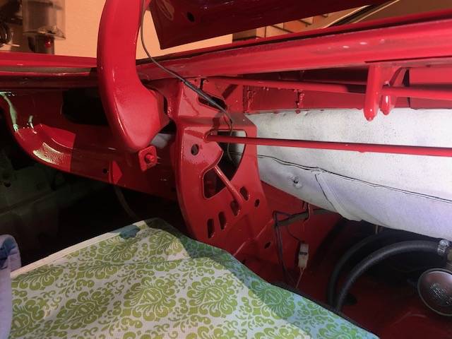

do you currently have an e body? if so, can you at some point post a pic of how the bars are supposed to be? the simple things sometimes F me up....thanks
Thanks a bunch. I thought possibly that’s what those holes were for. Thanks guy, much appreciated.

I have a couple... 70 is different from 71 I think 72-4 went back to the 70 design... Give me a few minutes & I'll post the 70 design...
It's a convertible, don't recall it being any different than a car with a roof...
I cold get photos of the other car tomorrow but it's a vert too so it wouldn't help...
