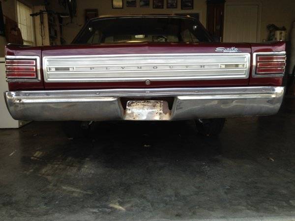

Ok, I'm going too jump in here.....What is the red paint on the trunk finish panel on my 66 Satellite and where can I buy it? Thanks in advance!
Try to find a spray can of the original Mopar QQ1, dark red poly (or similar) Then coat it with semi gloss lacquer. If You remove the old paint You have to use some primer first.
Paint is gone. Are talking
Paint is gone. Are talking clear lacquer?
Protect the red paint with "Diamond clear", satin semi-gloss. (Eastwood sells it) The shade of the red colour was supposed to match the turned off back lenses.
