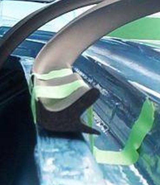

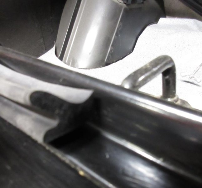

Let me make sure this is right before I glue it down -
Looking at what kryslerkid has here, perhaps I have mine backwards?

That looks correct.

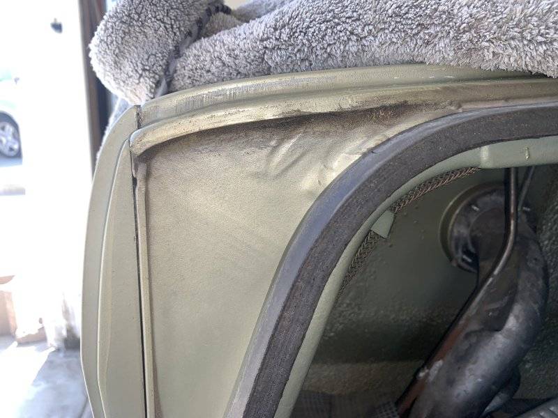

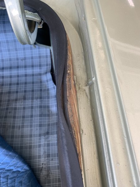

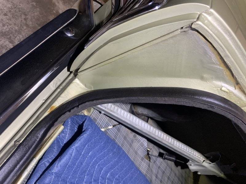

Looks like you put the split below the rear window? I thought about doing that, seems like it would look better than having it by the trunk latch, but maybe Chrysler put the split there for a reason.
That was a picture from FABO. I had my seam down at the latch like you have.
Split at back window will guarantee a leak, don't do it. It goes in center rear.
The split is slightly offset from the trunk lock - not dead center.
