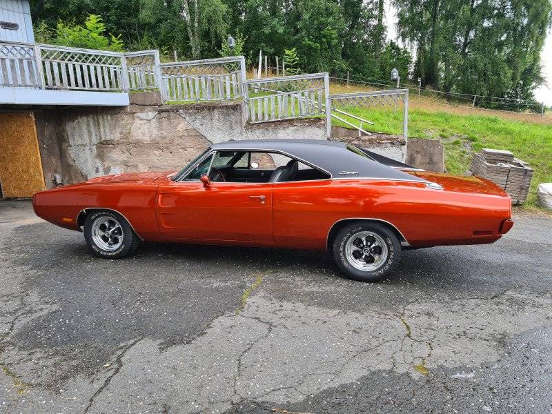

So 2018 i got a vinal top done at a shop and they did a shitty job the seams on the roof were crooked and the glue was coming off. A lot of talk after that and they promised to fix it but I never heard back from them.
2022 i found a shop that seemed promising, i let them do the job and the result was wonderful, the seams were straight and i was overjoyed to finally find someone who could do a good job as they promised.
In 2023 that bubble burst for me when I saw that it was starting come off here and there.
I contacted them about this but at the same time I had problems with the brakes which also caused my EFI to malfunction because the valve in the brake booster had gone bad.
This lead to some mental health issues, anxiety and depression so i couldn't deal with it. now i'm better and trying to deal with it again but don't know which is best. new vinyl roof or paint the roof.
The idea was to see if it would have been better to paint the roof black, i think it looks stupid to have the whole car orange even though you still have the moldings.
I love the "two tone" look but i dont know what it would look like pinted, the grill is painted black with a flat clear that looks good.
I feel that paint will give me less problem in the future.
What do y'all think?

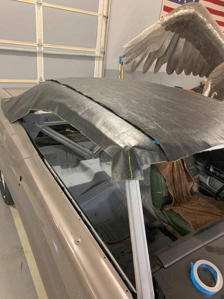

My experience is that the shops often don't use the correct glue, or not enough or ignore cure times. I had my most recent top put on by a marine upholstry shop. They put reference tape on the front and back glass to align the seams. I did the trim when I got the car home.
It just so happens I ran across this video yesterday. Some skill and (probably) lots of patience required. I'll do my car if I can get a car buddy in Savannah to help me out...it looks like a 2 man job to me.
It is not too difficult, especially if your trim has been off recently. Get it centered on the car, and glue one side at a time using the proper Weldwood Landau top adhesive. Your car looks great with a vinyl top.

I have now been in contact with the shop who installed the vinyl roof, the excuse they came up with was that the glue has had a chemical reaction with the paint. (Was painted winter 16-17 ) That it is the wrong vinyl roof (Legendary)
I got tired and angry and raised my voice and said that I am tired of people who do not take their responsibility. He said that he could not talk to me and that I was a pain in the azz and hung up
That's the new society unfortunately. Take your money okay but not too worried if they do the job correctly or not.
If I'm understanding this the order of work us
1) original paint 2017 - assuming to clear
2) first top 2018 which failed
3) first top replacement 2023 which has now gailed
if that is true, was the entire roof and C pillars stripped of previous adhesive, enamel primed then new roof. Or was the car repainted all the way to clear and the top installed. I've always heard that clear doesn't play well with the adhesives.
