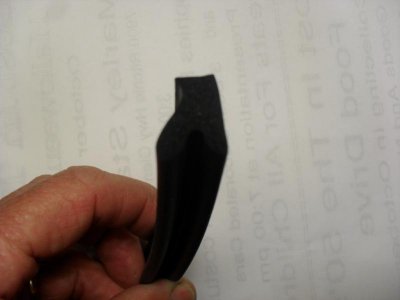

If I layed it just like the picture would that be going into the pasanger side channel or is that upside down (flip it over) and lay in the driverside channel?
SAM_1806.jpgThe "V" notch faces away from trunk opening the flat side gets glued down,see picture of Metro Supersoft I just purchased for my 63 Sport fury.

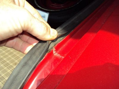

Here is the passenger side of an unrestored 68 Road Runner.... Hope this helps!DSC04864.jpg
Here's another from a '69 Satellite...
