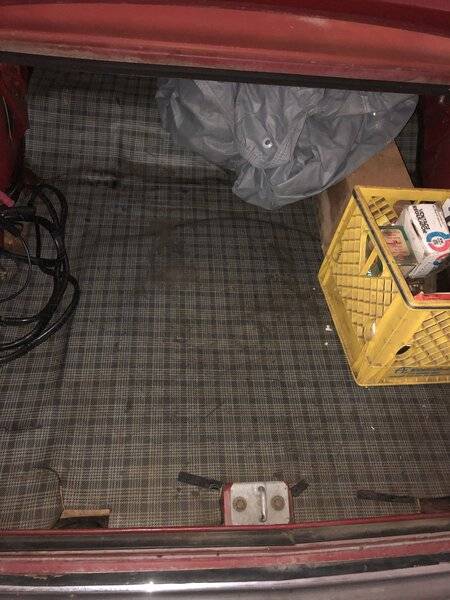

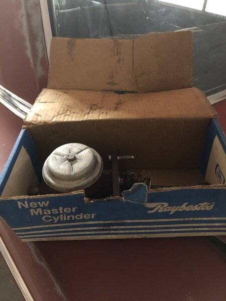

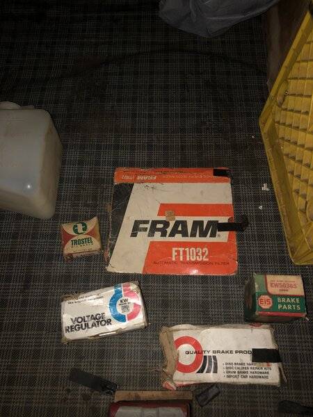

I got the trunk open. Ended up having to go through the back seat and remove the latch assembly. Found all kinds of old goodies in there. thank You everyone for your help.
Old goodies, now is the time to be a nice guy and :xscuseless:curious minds want to see.:D
I knew I should have added the pics, my bad.
