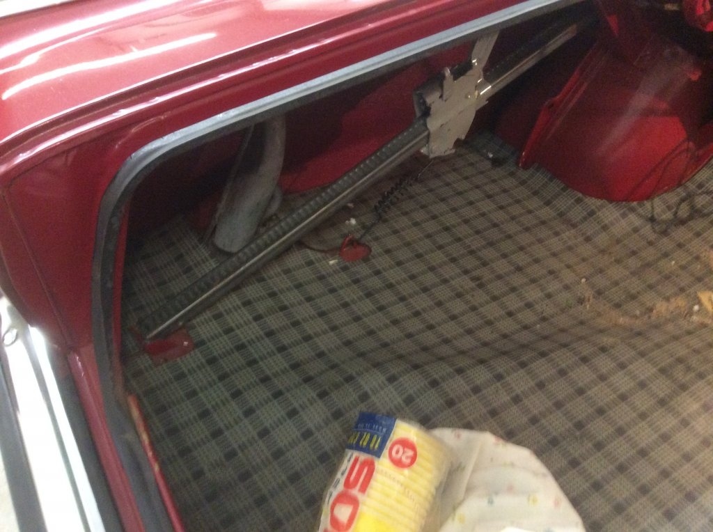

Could someone post some pics of their completed trunk? Finally have all the pieces to install the jack assembly but don't know how it's supposed to look.Its for my 66 belvedere.Thanks
Well after 25 years I thought it would be a good time to see if the spare was flat. Guess what it was flat. Your post got me to do it. If you read post say you read it.

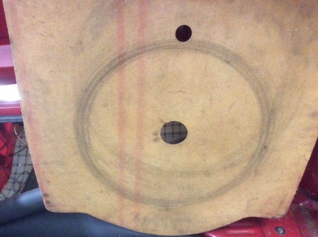

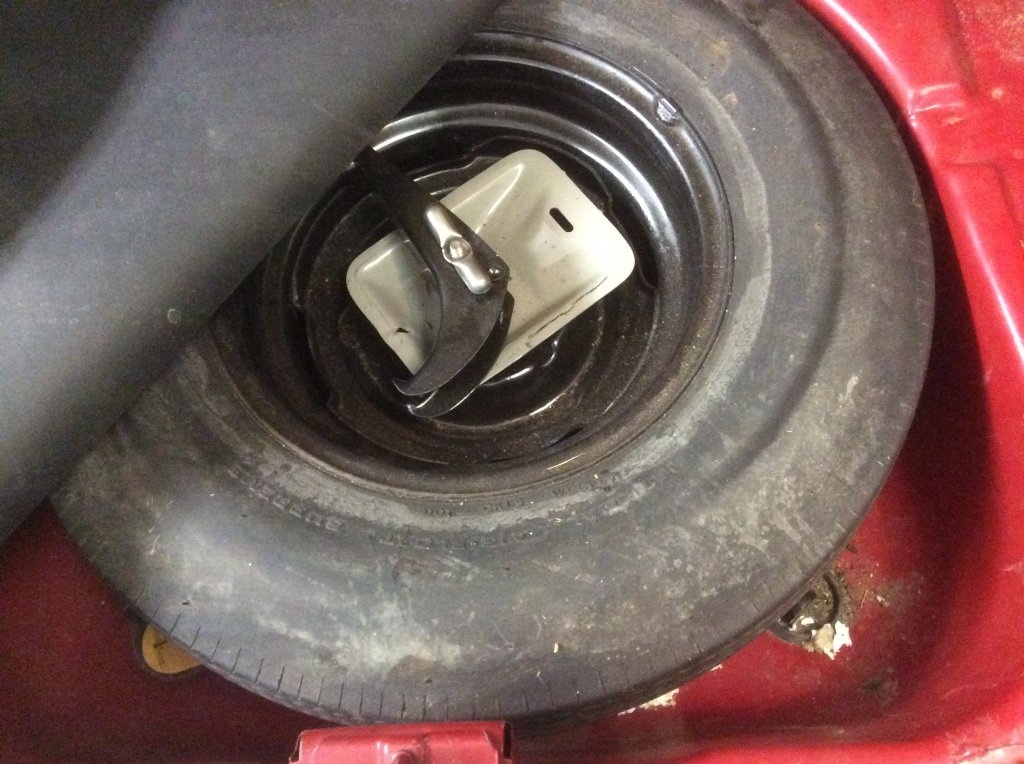

The lug wrench is held down by the tire. I have it to the rear, you may be able to see hex end sticking out lower right corner. Missing is the tire cover hold down. It's cone shaped and flat on the bottom. There's a hole to thread on to the stud to hold tire cover down. It has a bar across the top so you can screw it down. I couldn't screw it on spare to wide, it's around someplace. The small hole in picture 3 is a grab hole to raise cover.

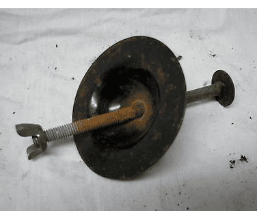

Thanks for the pics! I have everything but the cover hold down. Any idea where I can get one?
Thanks Fran- I have the cover but need the round hold down and nut. Thanks
That's a want to buy item. 66/67 repo stuff is limited, good luck.
I need the same hold down parts for my '66 Belvedere. Glad I clicked on your thread.
The ebay vendor didn't know the diameter, doesn't stock part. He must ship from manufacture or somebody's warehouse? This is another vendor I'm going to call him.
http://www.fusickautomotiveproducts.com/prodinfo.asp?number=ST618
Called above vendor O.D. 2-15/16 to 3" hole in my hold down cover 2-7/8 or so will re-measure soon.

I found one off a c- body and everything works.Ray at Halifax shops had the round cap.Any wing nut should work
If you what a factory look believe they used stamped steel not the solid ones. Bet you got it cheaper than I.
