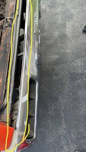

Trying to figure out if what I’m missing between my bumper and trunk is called “rear bumper filler” on my 74 Road Runner.

Im trying to order this part for my road runner but im not quite sure what right looks like. I can’t seem to find any google images that are close enough for me to see the bumper area I’m looking at. I think it would be called “bumper filler” but not sure (circled below in yellow). Also from the kits I’ve found how the heck is this installed? Similar to a door seal?
In order to meet federal bumper standards in the 70's, MaMopar extended the bumper and used fillers to the rear body panel and the ends of the quarter panels.
Thanks! Amazing info. I never would’ve guessed that. So the kits I see are for the sides and rear. It looks like I kind of just shove it into place, is that correct? Seems like a real waste of space but love knowing the back story.
Well, "shove it" is not totally accurate :lol: . You want a real waste of space, the Fords of the time were horrendously styled bumpers. We used to step on the front bumper & fillers as if it were a porch, when working in the engine compartment.
It is an interference fit, so yes, it does "shove" on.
...but I have heard from another member that the repro fit is not as tight as the OEM unit.
I only had to replace the end pieces on mine and was able to sand, paint and reuse the center.
Both the end set and the center are pricey.
Mine came from an ebay seller.

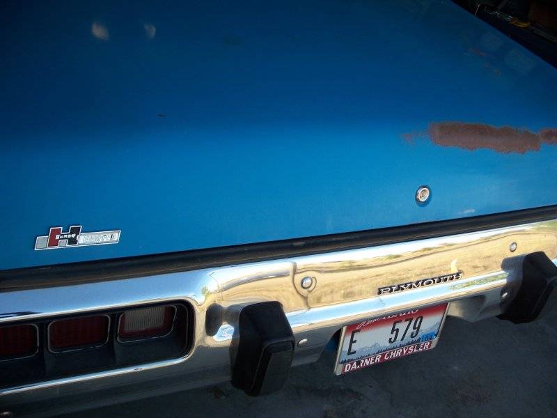

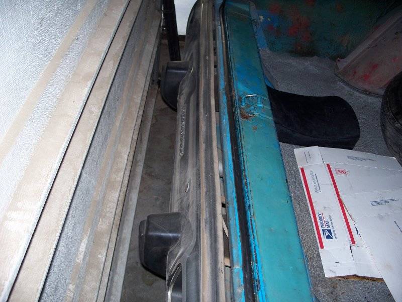

Here is an original one on my 73. It looks like it was painted black when new. I have had it since 1985 and I didn't paint it. Thought I would post some pictures so you knew what to look for. Yes I put the hurst emblem on it in the 80's.
Here is an original one on my 73. It looks like it was painted black when new. I have had it since 1985 and I didn't paint it. Thought I would post some pictures so you knew what to look for. Yes I put the hurst emblem on it in the 80's.View attachment 1532331View attachment 1532332
They are original "silver" like argent. I have nos corners and everyone I have ever seen was that color unless it was painted.
