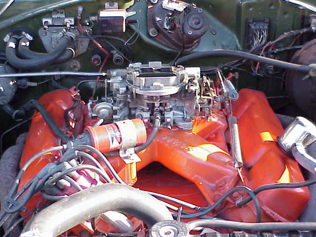

Pictures
I have plenty of pictures...what would like to see.
BTW....the fuel line goes to the carb and then down to the pump.
The things that I know that are wrong in the picture:
Heater hoses not hooked, A/C system ( I have it). Electonic Ing. anything else?
Looks like the fuel line is running straight out of the carb and towards the shock tower...
Lets see, the throttle return spring is hooked to the peg in the wrong place. retainer spring for your kickdown linkage is the wrong one, intake, distributor, and coil (as someone else said), heater hoses and A/C lines, #8 plug wire should run along the top of the passenger's side valve cover, should be "overspray" orange paint on the negative battery cable, probably the upper radiator hose (extra "kink" in the one for A/C), brake booster, distributor end of the plug wires should be a mix of 90* and straight boots, with all plug ends being 90* except #7 & 8, but all 90* will work on the plug end
that's a start from that pic
Fuel line looks like a good spot to maybe hang a light for working:grin:
My "69", You have a "Good Eye" for these things. I'm impressed :grin:
I've been at it a while:grin:
Ordinarily I wouldn't pick someone's car. But since he asked I thought I should offer up my observations:edgy:

WOW, 69 RR ripped that picture apart! But yes some of those things are wrong.:(

Anyone know where to get a stock Rad. fan and front bumper?
Front Bumper? What's wrong with yours (pic please). You should look for originals because repops suck, the fit is worse than what the factory called tight. Fan, all that stuff should be on ebay fan number is 2863 216 and the clutch is 2658 456
Correct on the fan......and for those who are thinking "how could he know that? You can't even see what fan it currently has." the upper hose is the dead giveaway. The HD cooling (26" radiator) had the upper hose on the passenger's side. That means the 216 fan and shroud.
Shrouds are available new from several sources
Oops....for a moment I forgot it's a 69 (since I've been workin on a 70) The 26" is a square top, while the 22" was a round top. Both are square tops for a 70
