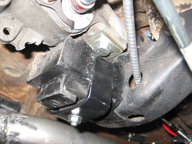

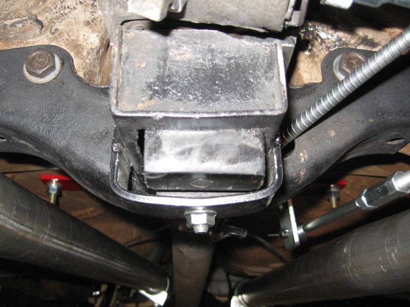

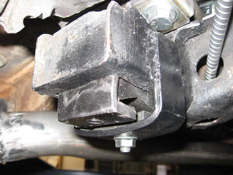

As funcarman said trans mount needs to be modified. I cut up my 318 auto mount to fit.
Yep, there's modification to do. Before pic, 64 Belvedere with later model K frame. I wanted to use collectors to accommodate the Moroso evacuation weld-in tubes and not have to drill my headers. Not smart and I wouldn't recommend it but brute force was enough in this case. Just lucky I didn't break any welds. Do what the other guys suggested and modify the mount.
