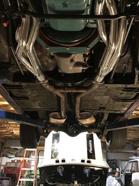

Just installed 1 7/8" TTI Headers with 3" Flowmaster Ex. Fit great - sound better. 440 with E-Street heads, Flat top Pistons, comp 268AH cam, H-Beam rods, Air Grabber, 727 shift kit, 3.5 sure grip

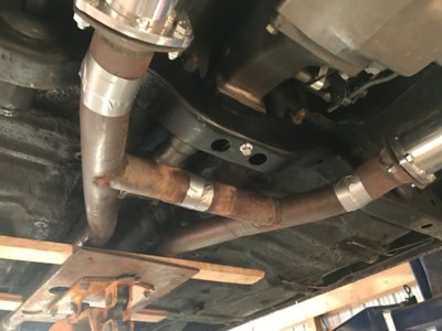

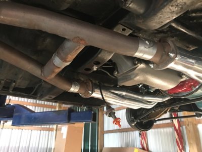

Glad I went with H pipe. Had to cut the pipe at the H and re-weld to make the pipe fit to the header flanges.
Just did the same thing on my coronet.
Headers fit without a single swing of the ballpeen hammer.
