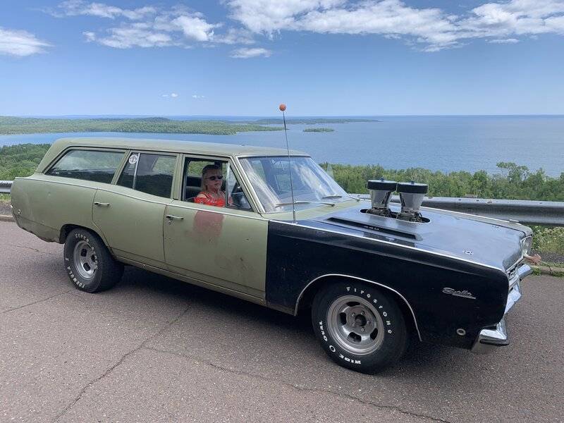

Have a set on my wagon and for a street car they work very well. lots of room. Definite horsepower increase over manifolds.
Starter access too.
