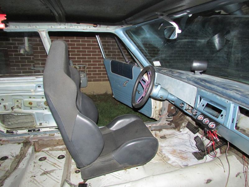

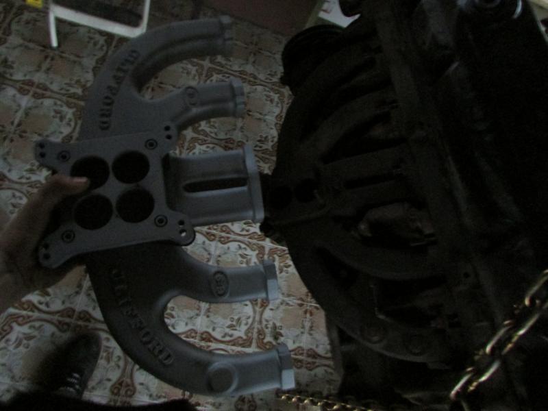

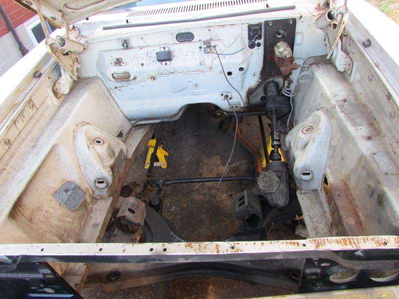

Before I stored the car for winter I put all new poly bushings in the car, c-body tie rods, moog balljoints, ss leaf springs 3800lb rate and I converted it to manual steering. The car is completely gutted, trying to get close to 2700lbs without driver, plexiglass windows are being considered. I have the engine and tranny out right now. Engine is a stock '71 bottom end. I'm sending out the head in the next couple of weeks to get ported and polished with big valves. Clifford 4bbl intake manifold with Holley 650 dp set up for blow thru. For now I'm going to use the stock exhaust manifold with a j-pipe to the turbo. I'm not 100% on the turbo size right now but I'm pretty sure on a t3 with a .63a/r (similar to a grand national). I'm aiming for about 12 psi to start. Tranny is a 904, going with a manual valve body and floor shift. Haven't decided on a driveshaft yet, but the rearend is going to be a spool with 2.76 gears. Hoping to work my way into the 11's by the end of the upcoming season.

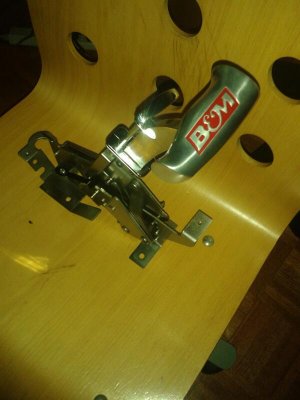

Got a B&M megashifter (ratchet shifter) for Christmas from my dad, and I'm sending the cylinder head out in a couple days to get ported and bigger valves in it. Hopefully it flows above around 210cfm, but who knows. Has anyone had experience with manual valvebodies? I'm pretty set on the Cheetah series ones, the more expensive one that allows engine braking (just in case). If I have enough cash left over after tuition and books I'll order the rest of the stuff for the engine and tranny and hopefully have it ready for when I get the Belvie from storage.
That's an awesome gift from pops. I have used cheetah manual valve bodies in the past. They work great.
