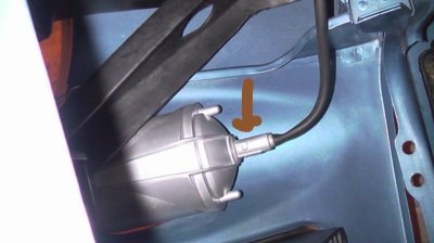

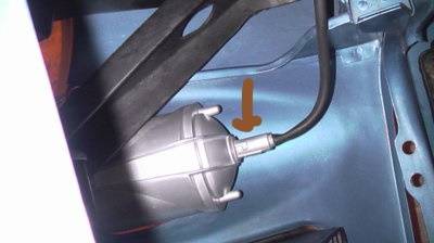

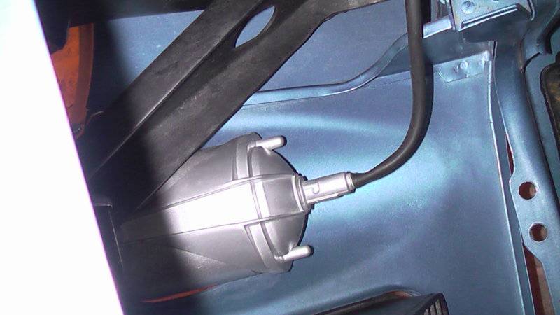

Don, try and rotate the socket a bit, sometimes it loses it ground between the socket and housing.
if rotate fixes it, then is a ground issue confirmation. Sometimes a small smash over the socket lip into the parking light housing will make a better fix than just simply rotate it. Maybe in fact with a screw driver
well i rotate it and it lit up,next ride will tell if it a forever fix or not.thanks all.
