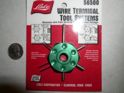

Here's a tool I have had good luck with.
