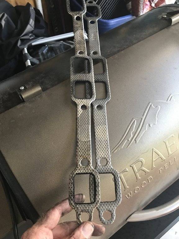

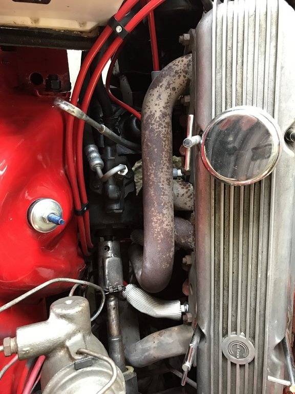

i developed a ticking under the hope and I believe it's the exhaust manifold. I took the manifold off and found two exhaust manifold gaskets with both metal sides facing the head, not the manifold. Weird. Hopefully this is what's causing the ticking.

Motor is a 383. I don't know what brand the headers are but they seem to be mad well.

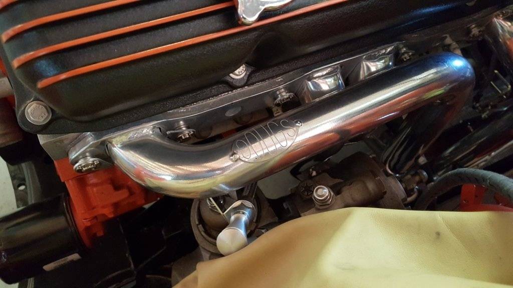

I'm aware they didn't come with them from the factory. I don't see issue with using one now though. I used FelPro because I've had luck with them in the past. I used red RTV high temp and put a small bead around the ports and snugged them up. I'm gonna let it sit for an hour to an hour and a half and then torque everything down.

I've never seen two gaskets before but I guess it can be done.
Previous owner had them facing the wrong way though. The metal is supposed to face toward the manifold. He had them in facing toward the heads.

It probably would've worked if he turned it the right way. I just started it and no ticking. I'll let the rtv cure over night. Hopefully it'll hold.

That's what I thought but I think it was because he was putting the metal side the wrong way. If he put a single gasket the wrong way it would've leaked fast so maybe he thought he needed to put two gaskets. It held for a little while but started leaking again I guess once I bought it.
