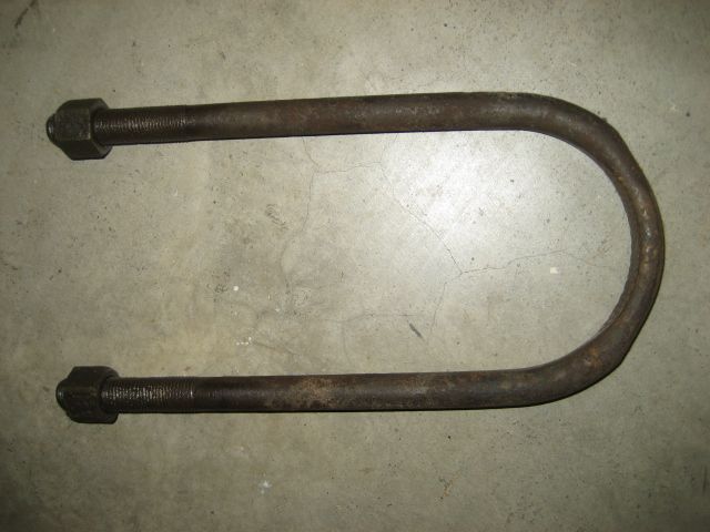

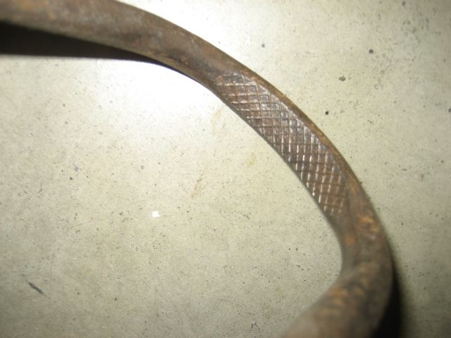

I am using the factory springs. Thanks for the info. Is this what you mean by flat top? I'm a little confused on the size wedge69 mentioned, can you clarify what the measurements are? Thanks
Factory "U" bolts
Factory u bolts are slightly flattened on the top & knurled on the housing side.
Good luck on finding that U/bolt after market !
I never seen a problem with the non flatened botl as the only reason the factory used it was to keep the rear from rolling the spring perch. Has Nothing to do with crushing the axle tube ! It a U/bult will deflect an axle tueb you Need to get a New rear OR Stop Over tourqueing the bolts. All in All the factory bolts are Weaker due to the Flattening of them> Just my 2 c'S but When you can plant a 4 speed B body with the front's 4 feet up you learn the weak spots!
Now this being said if your looking for a Factory restore than Yes go with that U/bolt. But if all your doing is trying to get your rear in and running an after market bolt will do the job for alot less $..
