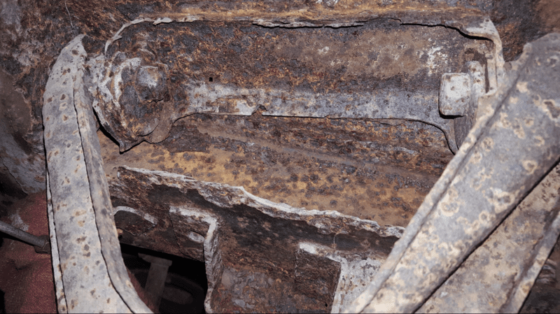

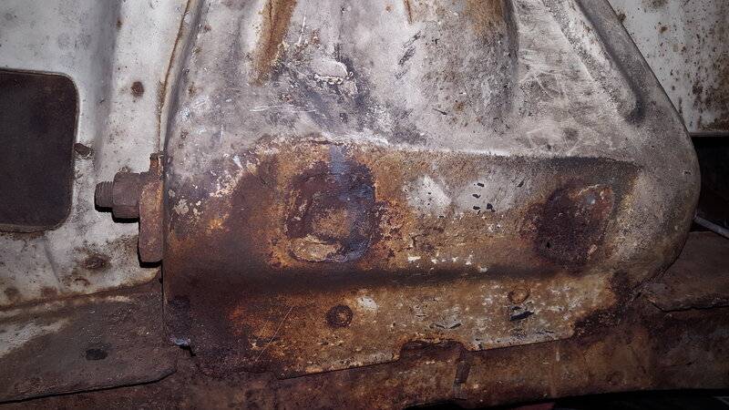

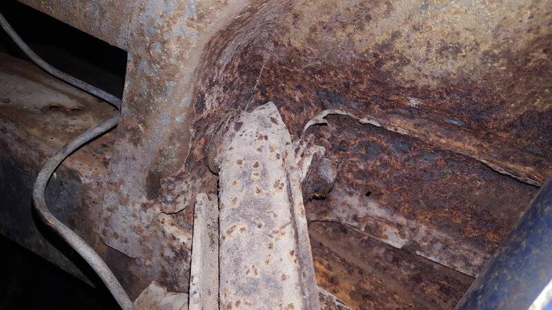

On my 62, the inner uca mounts are not looking too good.
The shock towers and frame rails are solid.
Can these be cut out and replaced with donor pieces?
You should be able to. I would start by getting the area media blasted, see exactly what you’re working with. More than likely the top of the frame rail is toast too.

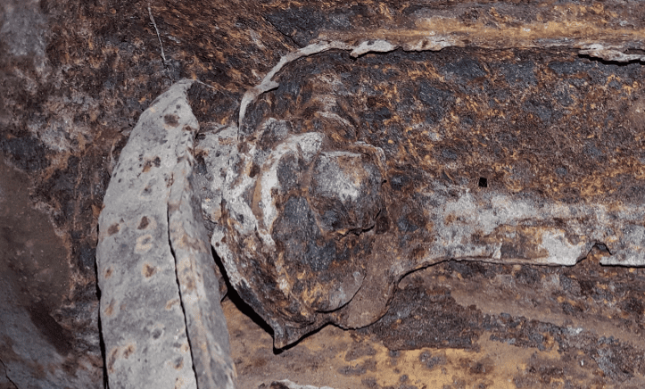

It's as bad as I think, and will probably crumble more when I take it apart, which I don't want to do yet because I need to move it.
The inner bracket just rusted away towards the rear.
It's supposed to capture the offset washer, but in the rear it's almost flush.
I beat the top of the rail with a punch and hammer, a little pitted but solid.
Inner bracket looks like it's welded via 2 square sections on the inner shock tower.
No one has ever had the same issue?

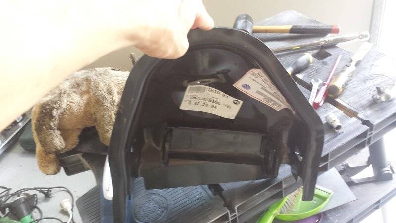

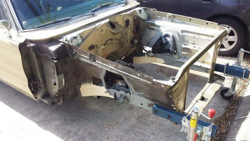

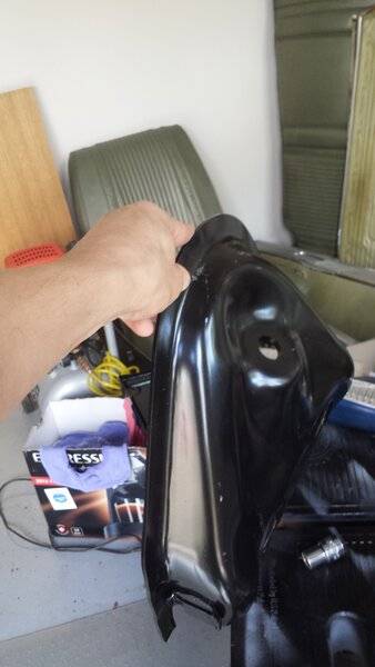

I had that same issue - bought new inner shock mounts from Goodmark I think. I can post up more details and photos tomorrow if you're interested. It was quite a job putting them in but the metal itself was pretty good quality.
I got these from Rock Auto - they are made by Goodmark - $83 each at the time (2016?). The quality is excellent except one issue which I only found after they were fitted - the slot for the UCA cam bolt wasn't aligned properly to the inner bracket. It wouldn't have been hard to fix at the time but is a bit more difficult once the car is on the road with engine installed etc. I haven't fixed it - it just gave me dramas trying to get the right camber setting which I resolved very cheaply with washers between the spindle. It may have been a bad batch or just poor quality control throughout. The steel itself seems good quality and very heavy gauge.
Thank you.

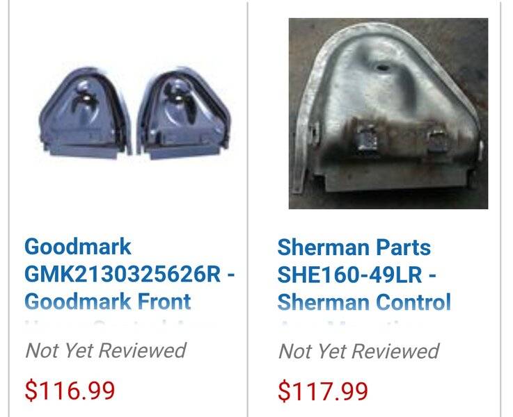

Looks like Sherman makes these as well.
Pic for Goodmark shows 2 but it's actually just the one side.
It's clear that the inner uca mount is welded to the entire part, but not made/sold as a separate piece.

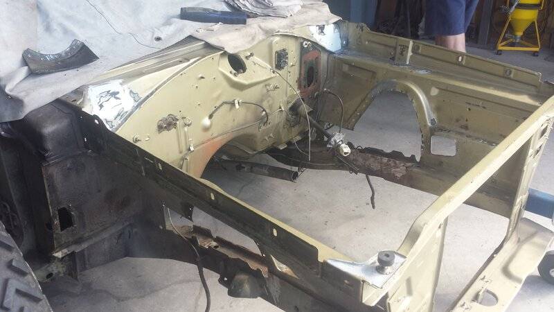

This was what I was concerned about if I found donor pieces, just the inner bracket.
Now, not so much.
I would figure using the outer holes to align the inner bracket would be fairly straightforward.
If I can find donor inner brackets I'll try that, or fixing mine, and then new.
